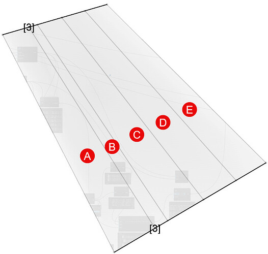

I need to use the Isolines of a bigger surface that I created in a specific order of parameters to divide the surface into multiple smaller surfaces. I tried to utilize List.Rider in the isolines of the larger side, and split the isolines of the smaller side at the intersection of the Isolines from the larger side, then putting the items with the same index from the above lists into sublists of a list and use that as input to Geometry.Split to get smaller surfaces without overlaps, like the following image without luck!

I would extrude the lines into a a surface, union them into a PolySurface, and then use a Geometry.Split to divide the base surface.
