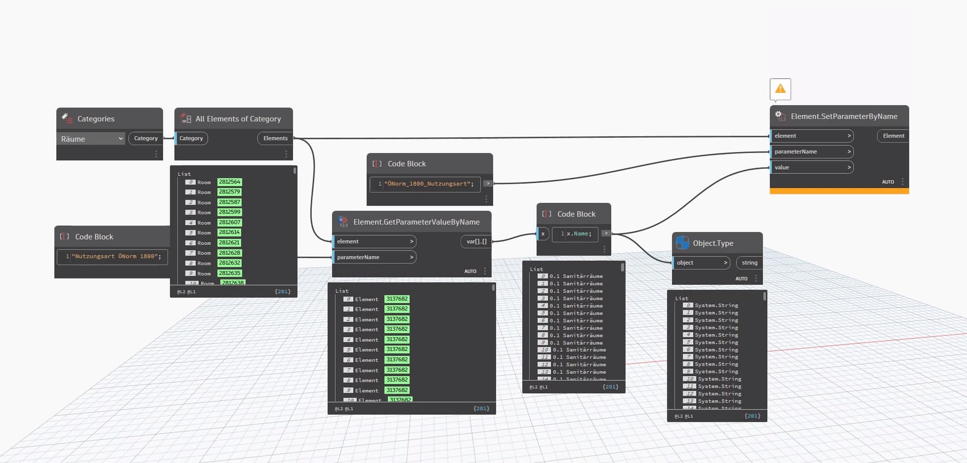

How to set a parameter triggered by KeyScheduleParameter?
When i do it it manually it works well, when i run the script it says “read only”. Thats a tipically Revit riddle :wink:
getting keys is fine, but how to set the project-parameter.
Are you talking about setting the associated values in the schedule or assigning a key value to an element? You’re getting the value as an element so you’d set it the same way. Just remove the Name node.
@Nick_Boyts ,
i need the name from the “key-Parameter” otherwise i would just have the key-parameter as a element. Actually it should be just get and set
i can understand that the result end up in an error - “read only” because the key set the value of the parameter, but when i do it manually it works.
You’re getting the key parameter from all those elements, which means they already have a key and the associated values assigned. So you wouldn’t be able to set any of the associated parameters to anything else since they’re controlled by the key parameter.
What is your workflow here? What are you doing “manually”? You have key parameters to drive all the associated parameters you want. Why would you then try to automate overriding those associated parameters?
@Nick_Boyts
i got it, i work only in this Key Schedule. in the screenshoot i collect rooms, that makes no sence.
So i have to work with the key schedule.
Can i get Key-Parameter as “active element in view” ?
Sure. They just don’t have a category, so you have to use a method that doesn’t specify. Data-Shapes has a node or you can always use the API.
