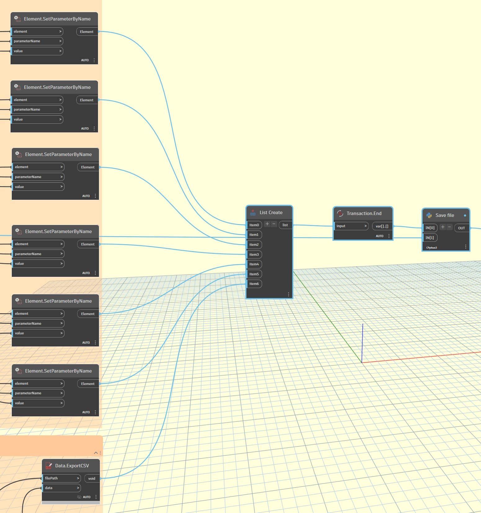

This is the script. At the very end there is the Python node with the code to save the document.
And this is the error that comes to the save node (the code is exactly the same you shared in the previous answer).

Thanks to both of you. Thanks to your answer I tried doing in this way and it works:
I collapsed in a list all the nodes which their output aren’t linked to a following node, then I linked the list to the node “Transaction.End” and then I saved the file using the this code:
clr.AddReference('RevitAPI')
import RevitServices
from Autodesk.Revit.DB import Transaction
t = Transaction(doc,"Do Something")
t.Start()
elem=IN[1]
t.Commit()
doc.Save()
OUT=elem
This is the custom node .dyf.
The OUT is the counter that counts the iteration for the LoopWhile node in the main .dyn script where I used the custom node.
In this way the main script save the Revit file at each iteration.
