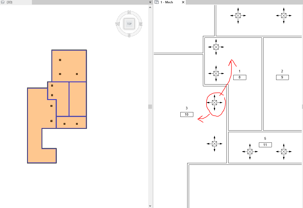

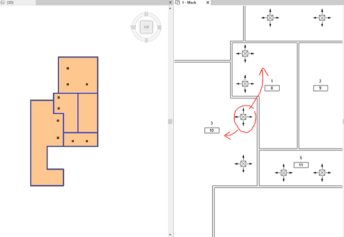

I saw all the posts and reply in that post it was a great but i have very simple stupid question if we are dealing with non geometric or non regular boundary of rooms like in the snapshot i think Bounding Box is not reading it properly and it will start to combined some areas together if someone can help on this
This Example make it more clear i attached, the highlighted Air Terminal should be part of Room 3 but when i created the Bounding Box based on the Room or even any other way in the script it become part of Room 1 which is wrong.
I think you should get geometry room and check intersection to filter element Air Terminal.
I did already i get the room Geometry and convert to bounding box then tried to get the intersection but the result as i mentioned
