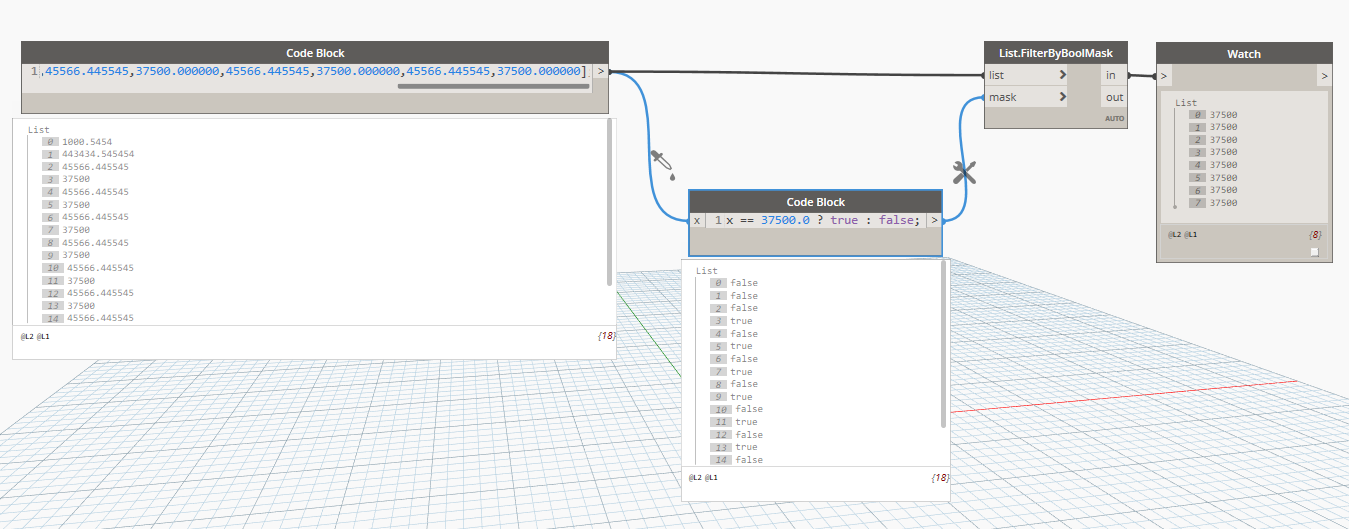

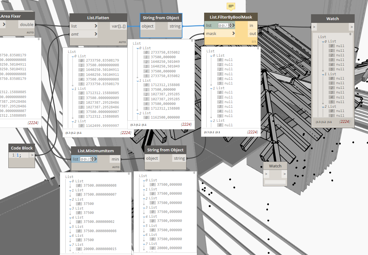

I have question. How can I make list with gives me result of true or false and select me only this numbers with are similar ? Now I get nulls but I want true or false if numbers are similar;)

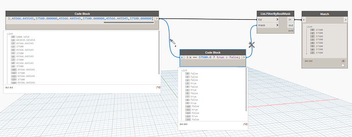

@krzysiektoja ,
hmmmm… you can use code block:
x == 37500 ? true : false
so you will get your boolean

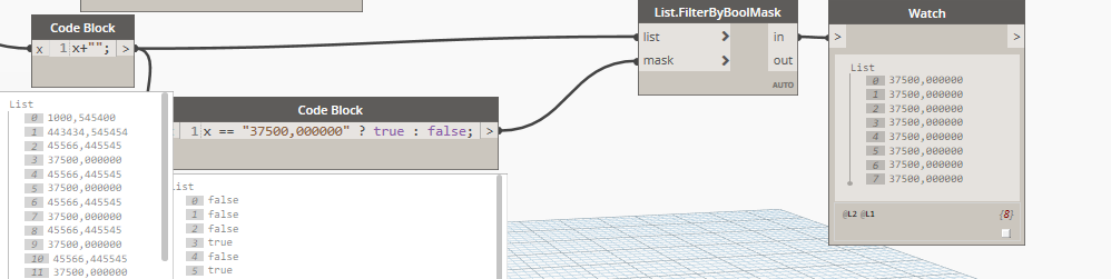

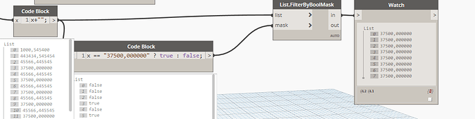

string variation

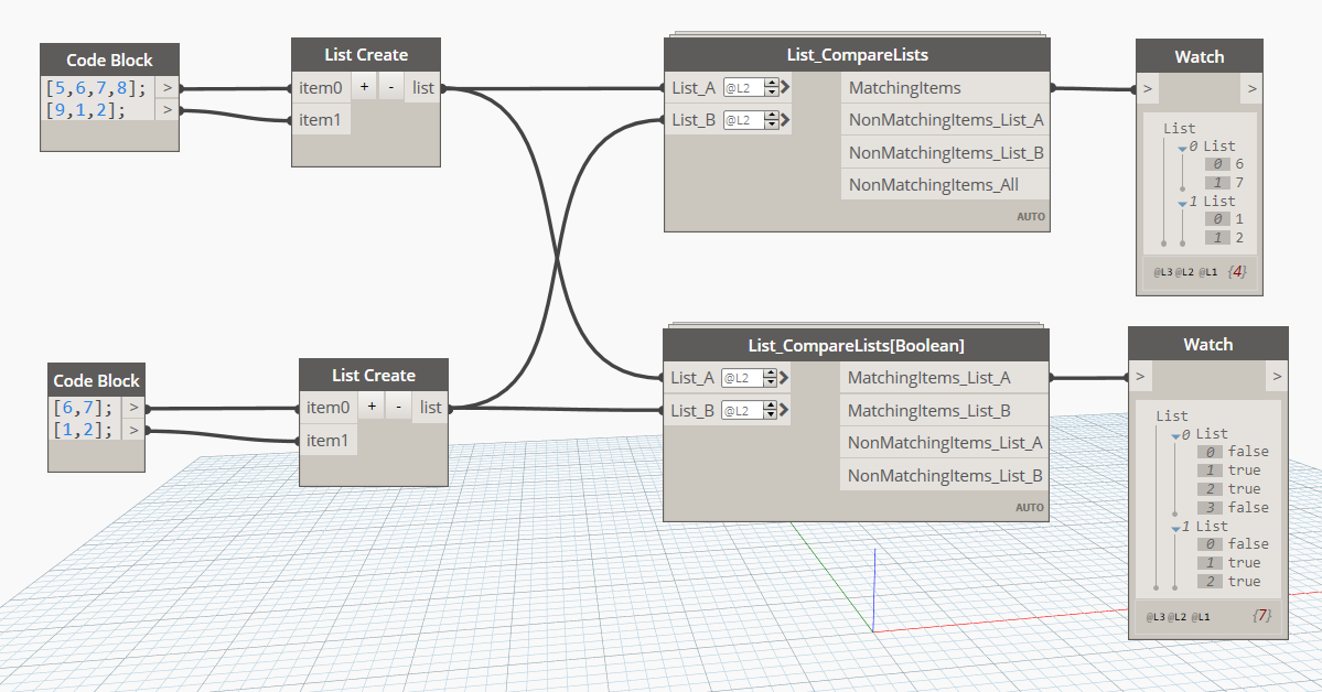

Hi @krzysiektoja,

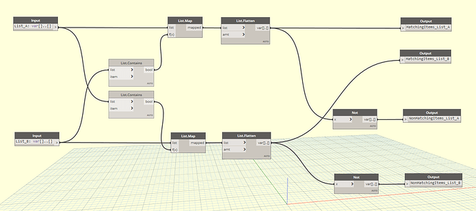

I’m using 2 custom nodes (local package) for that purpose.

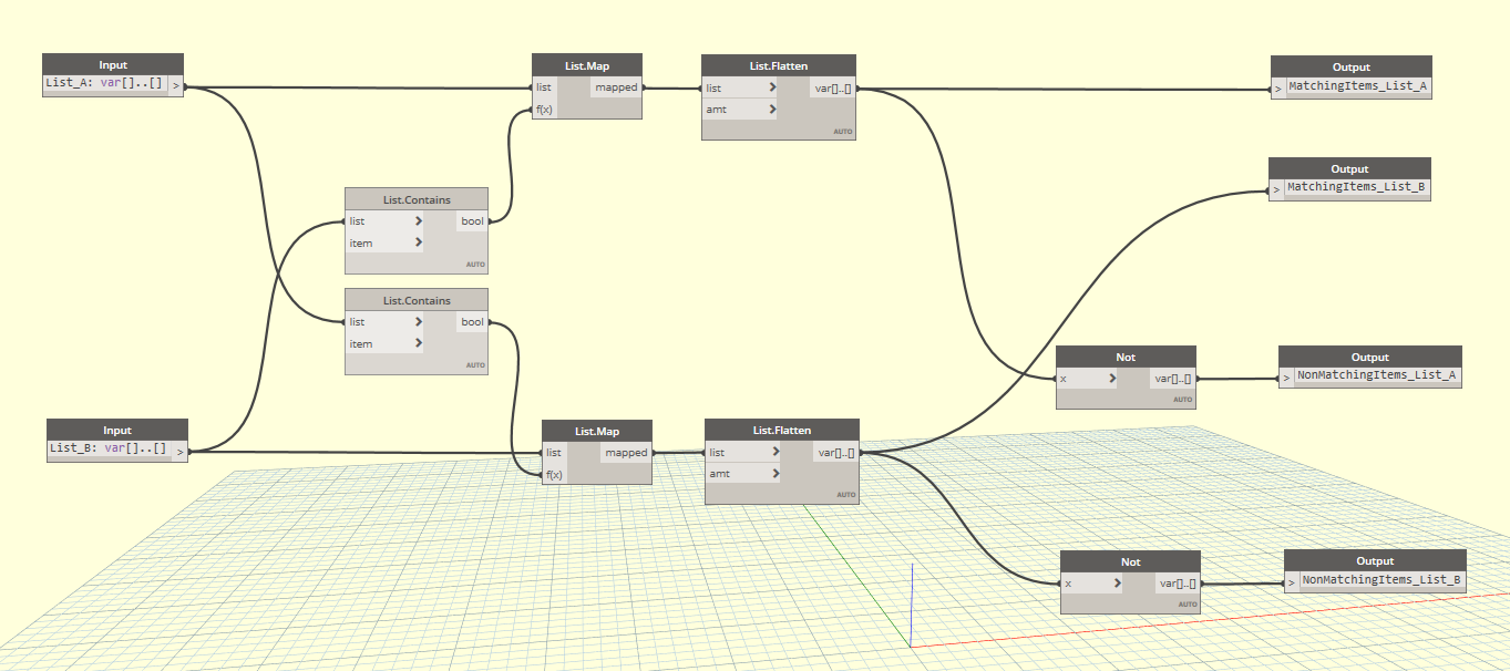

This is what is inside the “List_CompareLists” node:

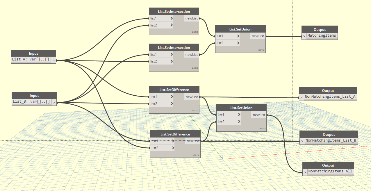

This is what is inside the “List_CompareLists[Boolean]” node:
Thanks it works:)
