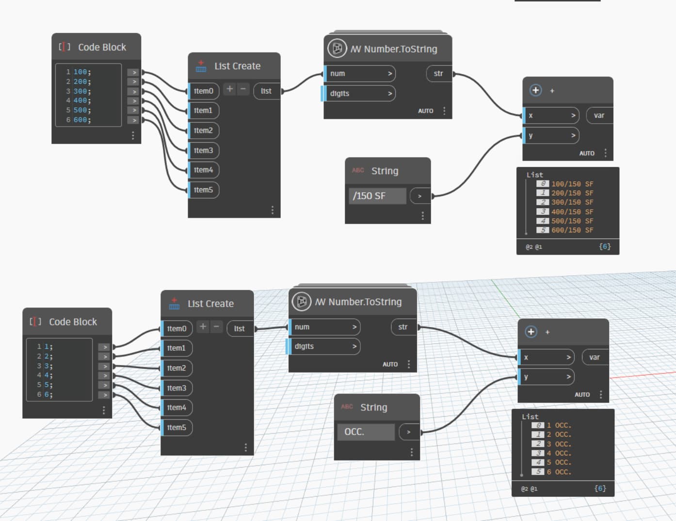

I am trying to combine two lists of strings to create one list but corresponding indexes at each row match up. So for example the 0 item is combined with the 0 item on the other list. However, I would like it so the item from the second list is on the line below the item from the first list. I have added a screenshot of what I have so far.
The main format I am looking for in reference to strings in the lists would look like:
100/150 SF
1 OCC.
200/150 SF
2 OCC.
300,150 SF
3 OCC.
and so on…
Any help is greatly appreciated and thank you in advance

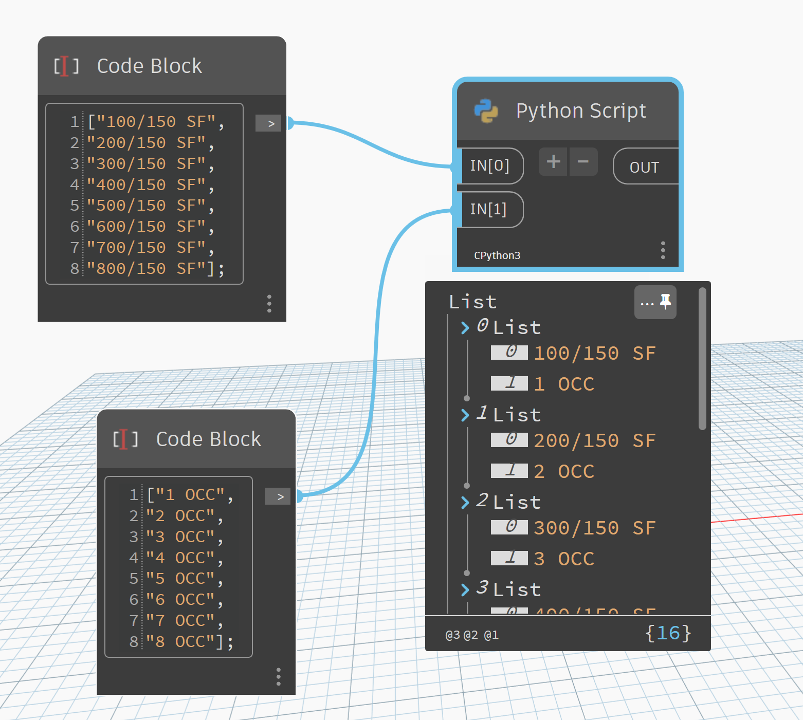

@Clayton.Woollen_UVKH ,
for that you can use zip function
string_one = IN[0]
string_two = IN[1]
OUT = zip(string_one,string_two)
KR
Andreas

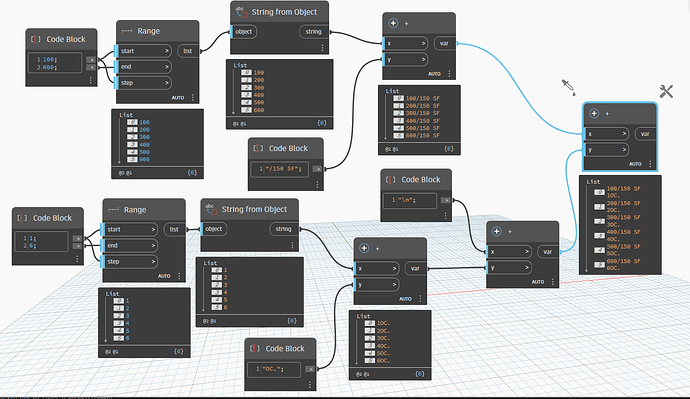

Hi, don’t hesitate to consult this reference document
too fast Mr draxl
(100..600..100)+""+"/150SF"+"\n"+(1..6)+" OCC.";
Sincerely
christian.stan

block codes can be replaced by number and string depending on the case
cordially
christian.stan
Exactly what I was looking for. Thank you so much!
