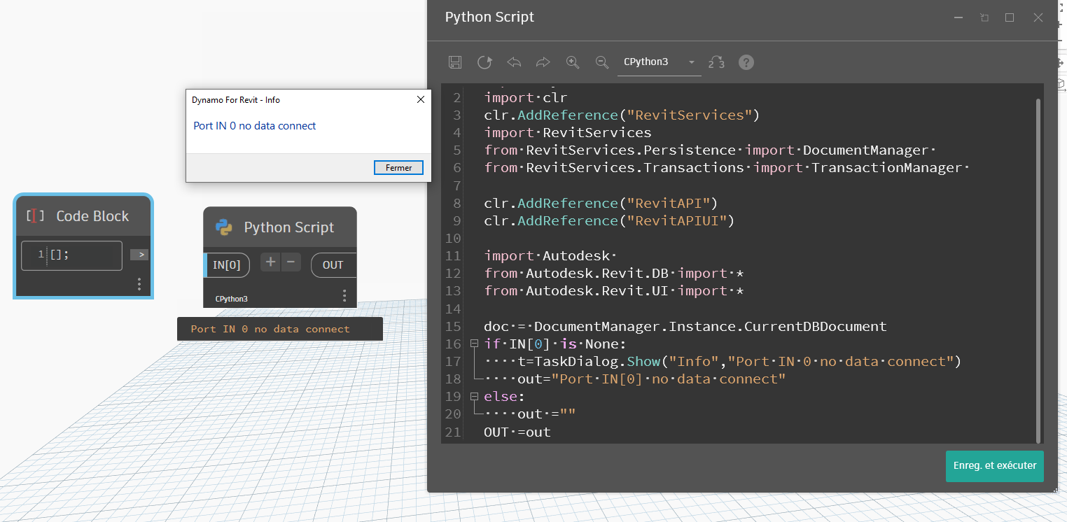

I don’t know if this can help you.
Sincerely,
Christian.stan
