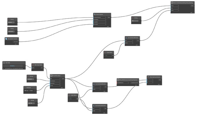

How do I finish this routine to introduce the blocks?
Translated by moderator. See below the line for original post.

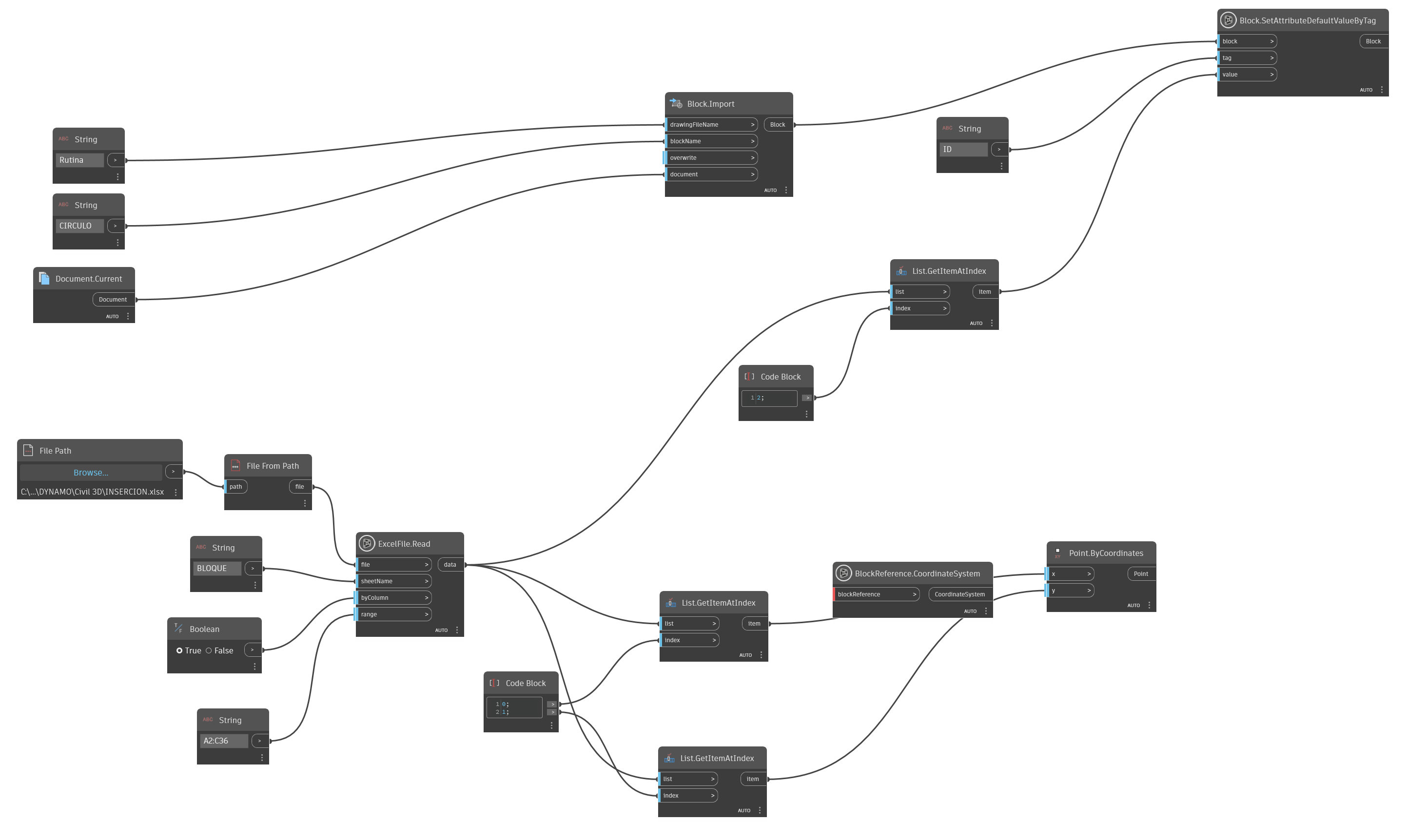

I’m creating a routine that places some blocks with their attributes in the 3D civil model space, but I don’t know how to finish it. I can’t find the node that connects my points given by coordinates with the attribute. Apart from the dynamo, as you can see, an Excel file is connected where I have the information. If someone could guide me, it would be greatly appreciated.

you are missing one step, you must create your BlockReference Instances firts, rigth now you are only improting the block definition to the file, the rest you are doing ok i think!!
