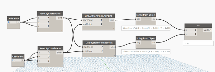

How can I tell if 2 pieces of geometry (curves or lines in this instance) which are generated by different methods are the same? I’ve tried using the == and List ContainsItem nodes, but neither of them are working. See the example below. I’ve made 2 lines using the exact same start and end points, but the == node returns false, even though the data shown for each line is exactly the same.

However, I bet you can maybe do a string comparison of the elements.
geometric similarity and object reference equality are quite different. Are we talking about identifying if two objects are the same in memory (probably not) or are we talking about identifying if two geometric objects are the same in terms of their geometry?
One is easy, one is really hard.
lines, curves and points are doable with some guesses, you can compare them using a type of spatial hashing which is essentially what @john_pierson does above using the toString() methods on the nodes, it takes different but similar lines and converts them to a string which is the same for both. You can do this yourself by implementing a function which takes a type of geometry and converts it to some string representation where many similar geometry objects will return the same string. For example - a poly curve might map to a list of start/end points that make up the curve, rounded to the fourth decimal place all concatenated.
@john_pierson @Michael_Kirschner2 Michael and John - thanks for the feedback. Sounds like the object-to-string approach would probably be sufficient.
John - I noticed that the node was a little different and I was getting an error even in constructing the graph the same as the image, but I think I can get it to work anyways. Also, just cracking open dynamo and python for the Rhythm nodes gives me some ideas for how to make this work. If you have any updated resources for these things, I’d love to see them.
