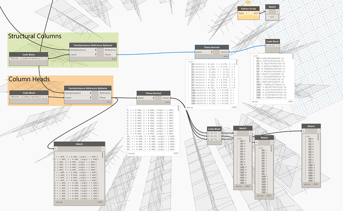

How can i get infos like location, oriantation in relation to the current project.
Actually i can see grafical in Dynamo! what i need, but how can i access it?

Hi @Draxl_Andreas,
The Output Reference has no geometric representation.
What you see is the Output Plane.
Once you got the references from the reference planes, you can obtain with the API a sketchplane or a plane. With a plane, you can obtain the normal (a vector) with the Plane.Normal node.

i know thats a pit off… i can t “call” a parameter from a refplane(?)
my next “solution” is to get the vector and his informations from the refplane
There is a near topic…
I can`t see values which are correlate.
Even when i have that, do i rotate my familyinstance?
