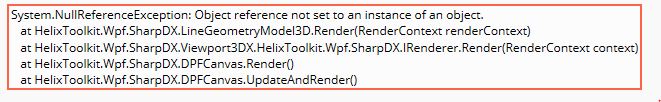

I have also received an error in my background which is attached as well.
Here is the error in the background (new user so I can only upload 1 image per post).
Error
