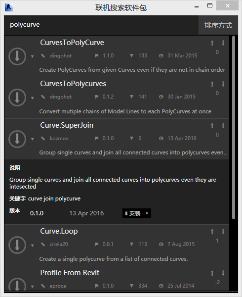

I am trying to join all joinable curves into polycuves. Now I have filtered out the single curves and have the index number of the curves which are joinable. But only two curves in list. Next step is to group them to get all curves can be joined into single polycuve. And that is what I am seeking for help. Following is the existing
