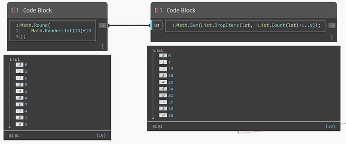

I’m currently working on a project in Dynamo where I need to calculate the cumulative sum of a list of numbers. I have set up a Code Block to perform the calculation using an imperative block, but it’s returning an empty list despite my attempts to troubleshoot. Is there any other way to achive results of first code block in more practical way ?

A solution with design script - there is no reason to perform imperative here:
Design Script
Math.Sum(List.DropItems(lst, -List.Count(lst)+1..0));
