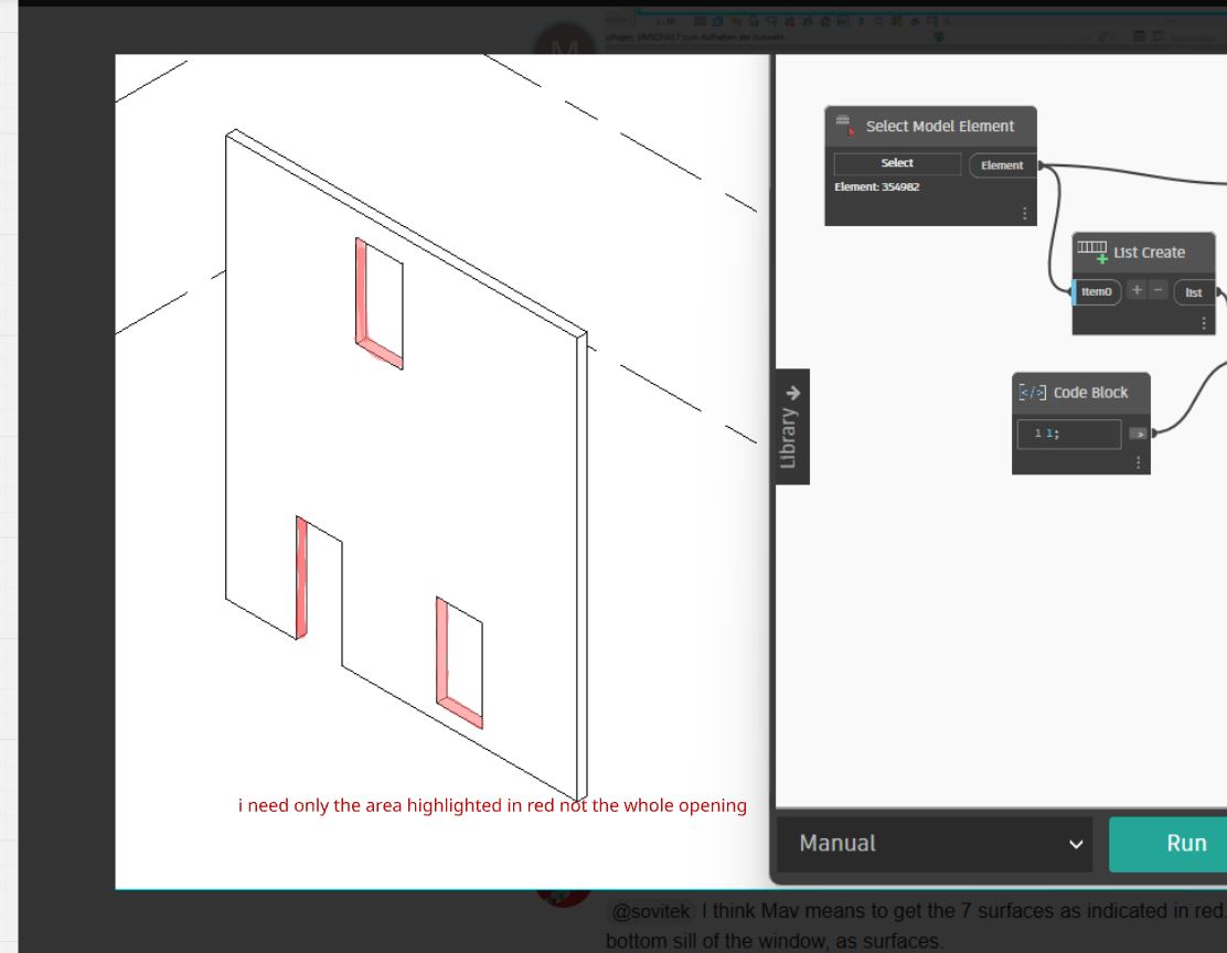

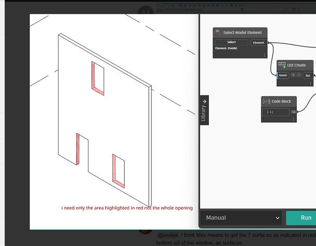

Does anyone know please how to get the area of the inner faces of those openings highlighted (a door and a window opening)? would appreciate any help.Thank you.
Hello @Mav ..something here maybe you mean ?
@sovitek I think Mav means to get the 7 surfaces as indicated in red. Like the top, sides and bottom sill of the window, as surfaces.
arhhhh my bad…yeah sure you are right :wink: :wink:
thank you @sovitek yes as @Daan mentioned i need those 7 inner surfaces not the whole opening
