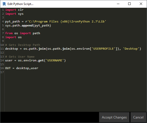

Does anyone know how to get the PC user name (not the the Revit user name)?
Trying to do a Dynamo script for the office but need a way to output to a folder on a users desktop so need to know the user name to complete the file path.
You will need to code something in python using the “os” python module.
Info on module: https://docs.python.org/2/library/os.html
Module will be saved in this location on your pc and will need to reference it from here: C:\Program Files (x86)\IronPython 2.7\Lib
Or
Another way to get the users desktop directory would be to do something along these lines: https://stackoverflow.com/questions/34275782/how-to-get-desktop-location-using-python
Thanks Brendan for pointing me in the right direction.
