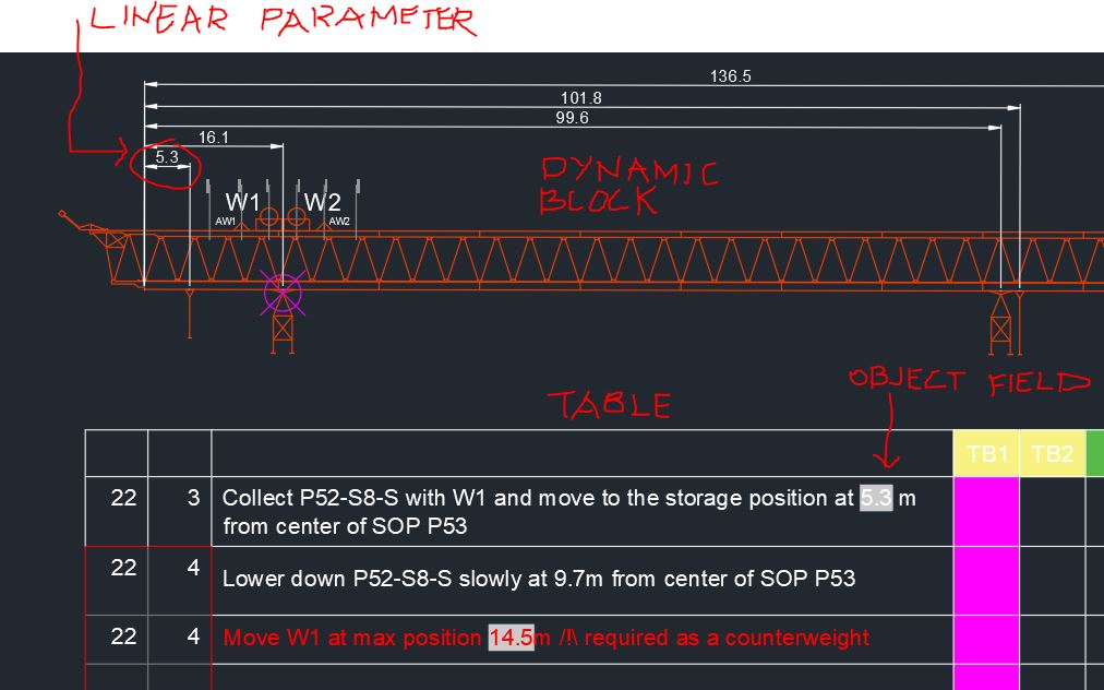

I need help on the task that i’m trying to do. Please see image below.
I have a dynamic block which i regularly update for every movement on each stage
on my drawing and currently, i’m updating the table manually.
Can someone help if it’s possible for me to use DYNAMO to complete this task?

Yes, i use this to get the values from my Dynamic block, but my problem is how to update my table with
these values.

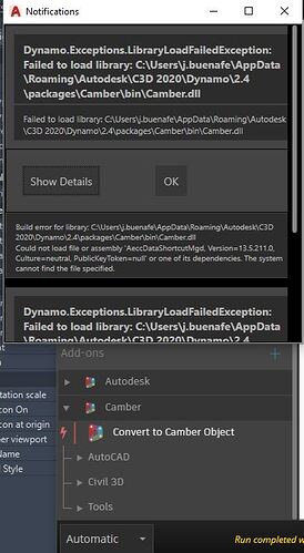

i have installed v4.1.4 but i’m having these error messages
@Joel_Buenafe please install the latest updates for Civil 3D.

I have not updated my C3D yet… as i’m using company’s computer. It has to go through our IT before i can get it done. In the meantime, I’m still hoping for alternative solutions.
