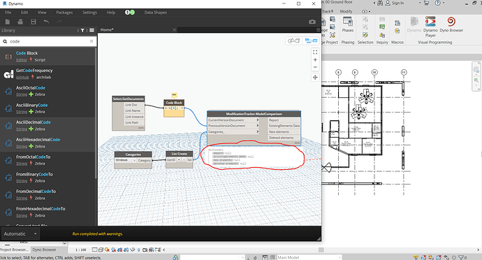

I am very new in Dynamo and I am already stuck on the first step. Could anyone please explain what should I do with the node ‘Get Documents’ to make this script work? Or how to work with that script in general?
Thank you very much in advance!!
Can you tell us the warning at the code block? It appears that you do not have any Link Doc.
Thank you for your quick reply!
That is exactly my point - I don’t know how to link the docs… Please take a look at the video: https://youtu.be/nvkOWz-FJg0
You need to link the document (Revit file) in Revit and pass that particular file to the Modification Tracker node.
