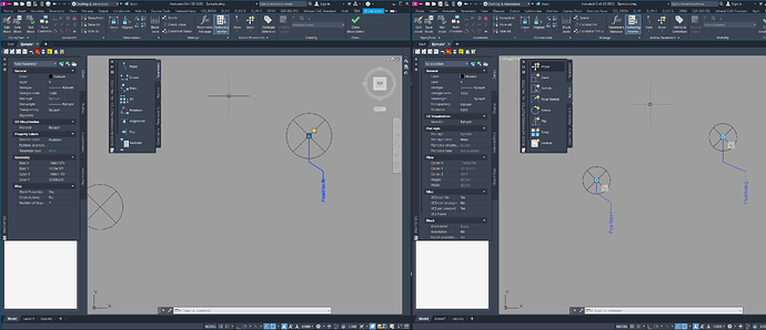

How could I get two coordinates from a dynamic block, inside the block I have another block, I attach an example
Ejemplo.dwg (934.4 KB)
Hola Amigo @Angel76 buenas. there you go!! :wink:
What I want to get are the two original coordinates of the block
Amigo @Angel76. My bad, i read only the title, is not need nest a block in an other, make things harder, i advice you instead modify your dinamic block to put only a point parameter with a move action, in this way you will can ask dynamic properties, simple as that, be careful not to overlap the block origin point.
