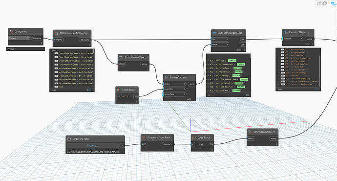

am trying to set up a simple script to automate the export of NWC of specific Views filtered by name. I keep getting the error on my Python Script block in Dynamo when I try to run it:
NameError: name ‘FilteredElementsCollector’ is not defined [‘ File “< string >”, line 22, in < module > \n’]
See attached dynamo script and python code. What am I missing?
I am using Revit 2024.3 and Dynamo v2.19.3, see Dynamo error below:
See rest of Dynamo Script:

remove the s , the good class / constructor is FilteredElementCollector
Thank you for the insight @jacob.small !
@c.poupin Oh my gosh thank you. Now it says my ViewID is not defined
I think I am onto something, did not get an error this time. But still the folder did not populate with my NWCs.
For everyone on this thread. This was what worked and exported all my filtered 3D views as NWCs to the designated folder. Appreciate the insight.
