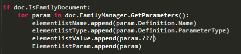

I would like to know how to do it in order to get the value of a family parameter working in the family editor.
I’ve tried this, but as Revitapidocs says, ther’es no attibute for Value:
imagen

I’ve looked that I could GetParameters, even SetValueString, but I can’t find how to get parameter value that is what I would like to achive.

Hello @Manel_Fernandez
to get the values of parameters, you need this class
here is a small example, (values ​​vary according to each type)
out = []
if doc.IsFamilyDocument:
	famManager = doc.FamilyManager
	for familyType in famManager.Types:
		paraTypeDescription = famManager.get_Parameter(BuiltInParameter.ALL_MODEL_DESCRIPTION)
		typeDescriptionValue = familyType.AsString(paraTypeDescription)
		out.append([familyType.Name, paraTypeDescription.Definition.Name, typeDescriptionValue])
OUT = out
