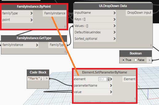

Hi all, I have a set of family instance, know I need to change this family instance to element. Is there is any possible solution is there. Because of I going to set the value in Mark parameter.Thanks

Could you show the error?

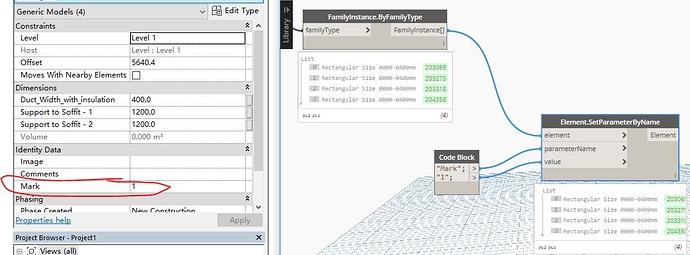

FamilyInstance is a sub-type of Element. Element inputs will always accept a FamilyInstance but a FamilyInstance input won’t take just any Element.
sorry @windzxy I didn’t take snap on error time. But known its working fine.
