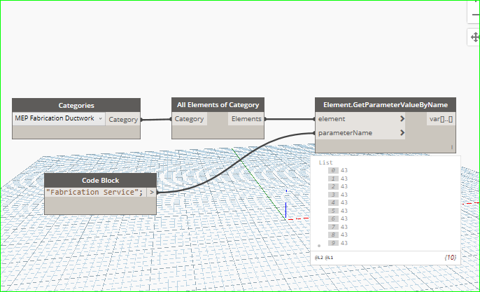

how can convert Fabrication service id to service name. I created as below. Purpose of this Dynamo is to filter the fabrication parts by fabrication service name
You can also check what else these elements can give you with the Element.Parameters Node. This will show you all the parameters you can query from the element. If you do this you’ll find out these elements also have the parameter “Fabrication Service Name”. This will give you the name of the service.
