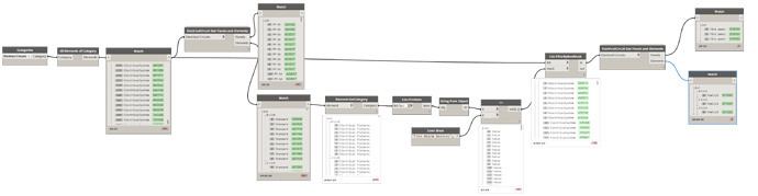

i think this will help you , if not give me a feedback,
Thank you for your reply,
unfortunately didnt work, since in some cases there are multiple elements under a single panel, as you can see in the image below.
i need to do the following correlation:
for the first element under panel 12: “PTF 128319” associate with “MU 129290”
for the second element under panel 12: “PTF 128320” associate AGAIN with “MU 129290”
… (in case there were more than 2 elemets)…
for the x element under panel 12: “PTF xxxxxx” associate AGAIN with “MU 129290”
the output list has to be a list like this, and have to be a correlation between the index of the element from the list elements (list 1) and its panel in the same index in the list panels (list 3)
|0 MU 129290|
|1 MU 129290|
|x MU 129290|
where at index 0 i have the panel of the element at same index (PTF 128319) in the list of elements
at index 1 i have the panel of the element at index 1 (PTF 128320) in the list of elements
and so on.
in addition of my example above continue with the following
let me know what you got
Thanks a lot for Your time, it works.

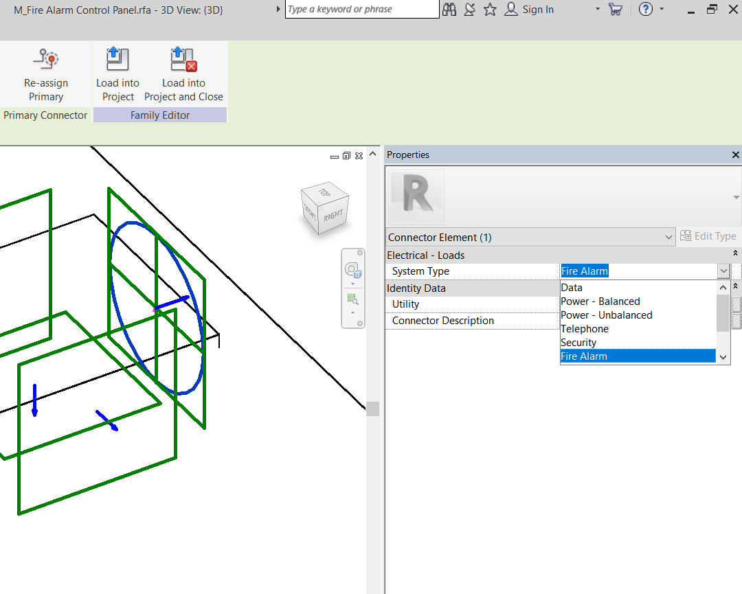

I have one last question, in the first image you posted, the “fire panels” on the top right corner of the picture. what is their category? fire alarm devices or electrical equipment? because i tried to set a fire alarm device as a “panel”, but i couldnt, i had to change category, into the electrical equipment.
Is it possible to set a fire alarm device as a panel without changing category into electrical equipment?
so happy that is worked :slight_smile:
for your question yes it’s electrical equipment, any distribution system needed to be a panel thats mean “electrical equipment”, this is how Revit work with fire alarm system.
in the family of electrical equipment there is electrical connector you decided to be power or fire or any system else
