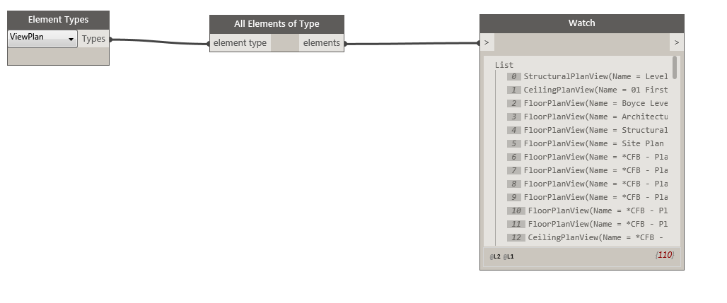

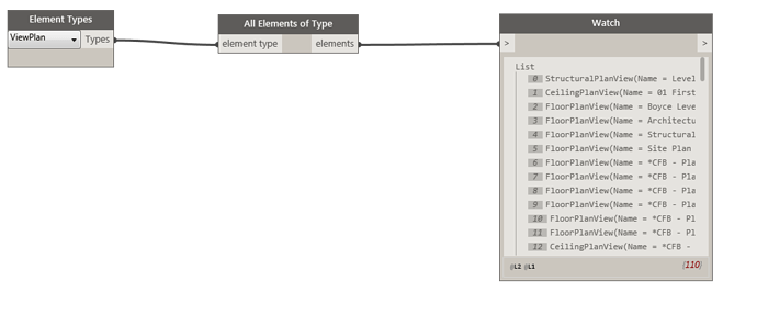

Hi @and6rea
If your looking to duplicate plan views you can get floor plan views by using element types as shown below and then filter them by view names “BMS” to duplicate BMS views.
I started with that node as errors typically lead to other errors which slowly compound themselves as you go, so best to remove the first error and work your way along. Since you’ve gathered a view template, my guess is that this is the first issue as the parameter names are different. It’s unlikely you want to duplicate your template anyway, and definitely not duplicate it as a dependent (how can you duplicate a template as a dependent?). So i’d start by changing your collector to the method @Kulkul illustrated. If it still is throwing the same error, please upload your DYN and a sample RVT file to test it on to either here or another file share (google drive, dropbox, box, one drive, etc) so we can be sure we’re helping with the right solution.
