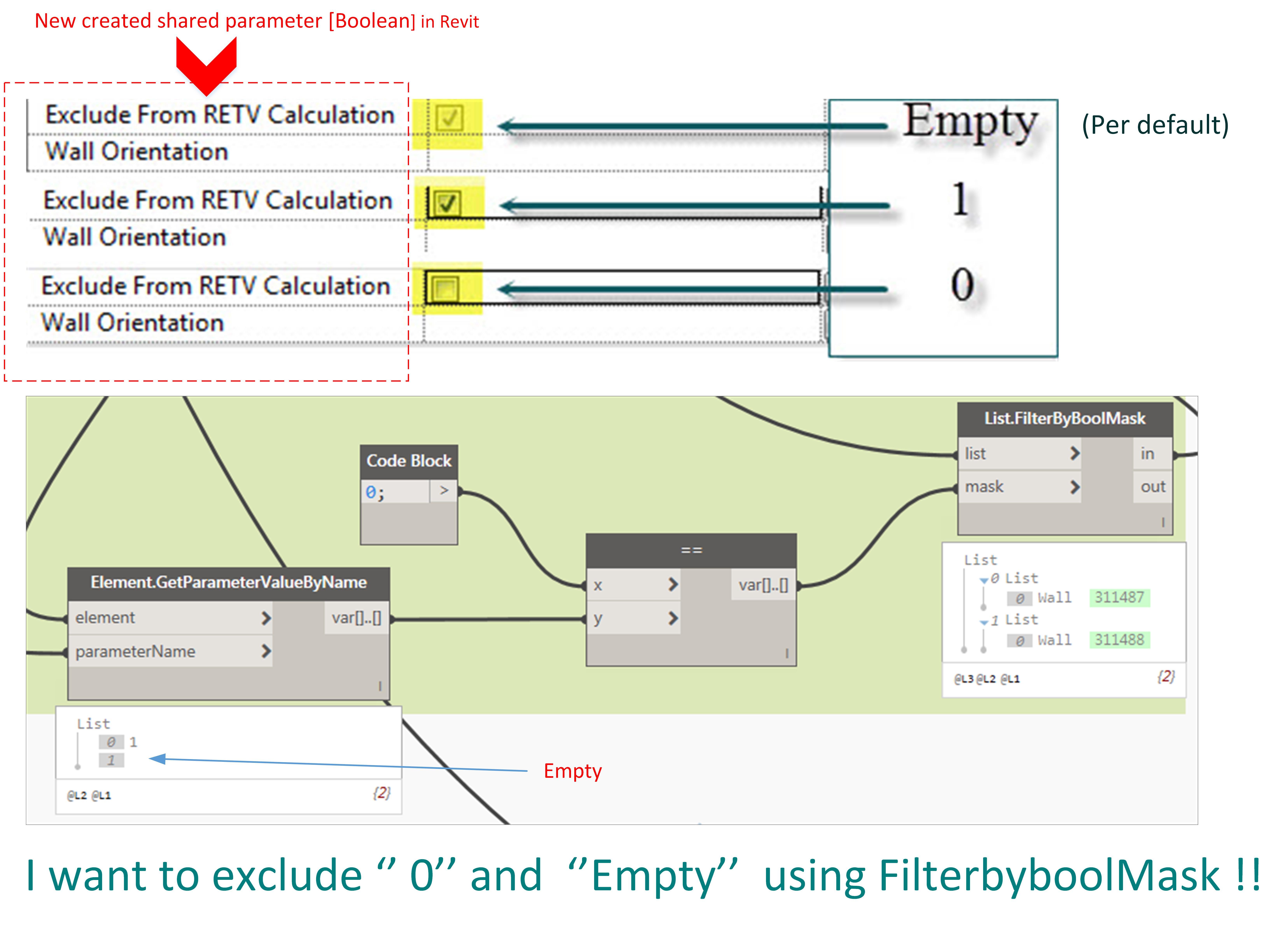

i want to use the filterbyboolMask to exclude “0” and “Empty” values of a shared parameter that i have created for wall elements in Revit. i could not find out how to create the double conditional function especially with the Empty value !

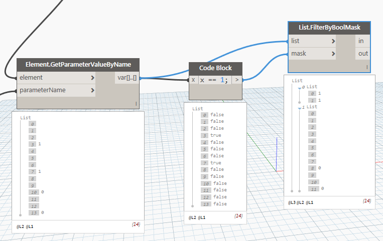

Since you are using a yes/no parameter you can just filter for the value you do want and exclude the rest, like this:
