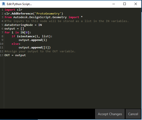

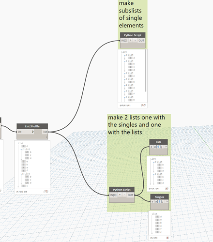

I see 2 approaches here:
I’m not completely sure what happens here (my Python knowledge really isn’t good enough for that).
If I’m understanding correctly, with the first python script you’re basically doing what I was doing in Dynamo but in Python, which then works because it’s in Python.
Here’s a node approach for the second option:
