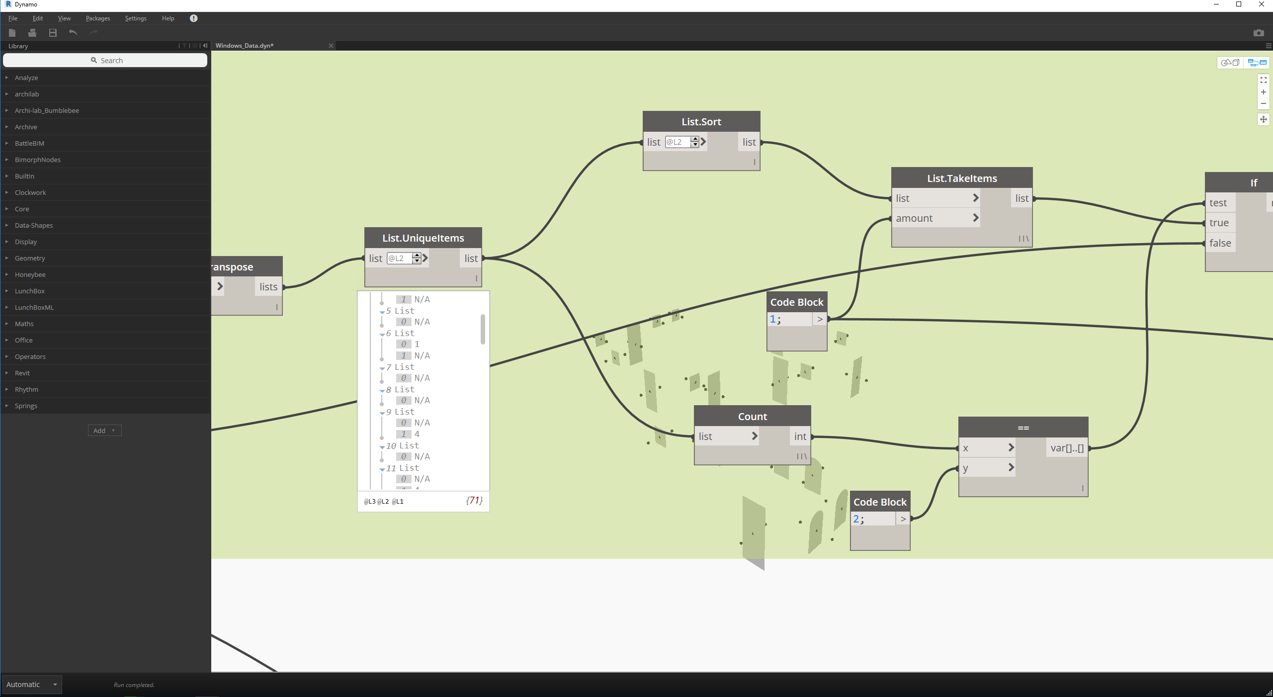

I dont think I have explained it correct.
This is the actual list.
What I need is to delete all the N/A but only when there are 2 items in the sublist.
So if a sublist is 1 and N/A it should be 1. And if its only N/A it should still only be N/A.
@moeng perhaps you could use all true and filterbyboolmask?
Does this yield the desired result?
FORUM_ListDeleteIf.dyn (36.2 KB)
Exactly! Thank you.
