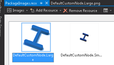

Ok I got closer, but wrong image.
I was trying to rename the files to match by Package.
ie. PackageImages.resx to OpenStrcImages.resx
That didn’t work even after I changed all references.

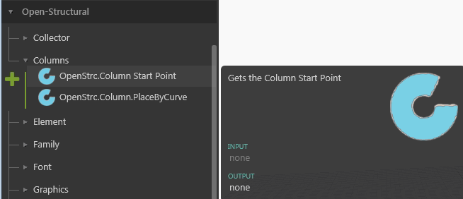

So I was able to change my icon, but it’s this big “C” and not the images I have in my Resources. Actually I have no idea where these images come from.
When they should be:

It looks like Bakery was overriding his icons.
