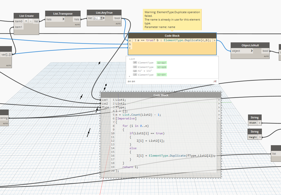

I’m thinking looping might help in this case. But I suppose DesignScript alone does not support “for” loop. I was trying Python scripting for the first time in Dynamo, but can’t get the code to work. I’ve just started learning Python a couple weeks back. Following is a crude version of what I want to achieve through the code (I’m familiar with Python keywords but only ever coded in C++ or DesignScript, so the code below is a mix of both).
> n = List.Count(List1);
> for (i in 0..n)
> 	{ if (List2[i] == false)
> 		{x = append(ElementType.Duplicate(fType, List1[i]));
> 	else
> 		{x = append(List1[i]);
> return x;
Here I’m taking three inputs, two are of list type (List1 and List2) and the third is a FamilyType (fType). List1 has a set of unique items to Duplicate and List2 has the same number of boolean values.
Could you tell me how to convert this to Python script?
May not be necessary. (Refer to the Associative code block below)
It does. In Imperative mode (Example provided below)
ImpAndAsc.dyn (9.4 KB)
:open_mouth: Thanks for introducing me to Imperative language block! I read about it just after reading your reply.
And kudos! This is exactly the solution I wanted.
Both the code blocks work perfectly. Although associative code block shows a warning, the output shows the desired result without any null value, so must be just a bug.
I just realised that the associative code works just like what Mark had said, that’s why it’s giving a warning error because both the functions are getting executed for each unique item, but only the function output that satisfies the conditional statement is getting returned.
This also is a part solution so marking this as a Solution as well. :slight_smile:
