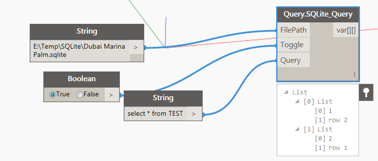

You’ll need the Dynamo Slingshot nodes, plus the SQLite ODBC driver.
http://www.ch-werner.de/sqliteodbc/
I’m using the 64 bit version- have only used SELECT queries, not INSERT etc
Andrew
correction
you don’t need the ODBC- Slingshot by itself will do it

I want to use lists in queries, so I need to organize “for” cycle to query for each element in the list and collect results in another list.
Level up! The question is: how to connect an external Python library apart from Revit API and related.
I’d suggest creating a new post with a different title
Incidentally for this question:- [quote=“Nikolay_Gerasimov1, post:6, topic:4344”]
[/quote]
You can do that like this:
