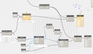

This got me thinking of ways of comparing the whole XYZ location at once. So I converted the numbers to string which allows me to compare the whole number across the numbers in the list. This works perfectly for what I need however I have come unstuck again. If I have a situation where im feeding in more than one point and want to cross check them all, if I convert to string it will obviously combine the all the numbers in the list into one. How can I run a compare on several points without having to call them out individually? The string remove is just removing the { } from the string. Maybe the initial way I started was a better method. Any ideas…?

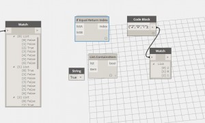

Okay stuck again! If I have a nested set of lists, with true and false values. How can I go through the list and pull out the index number of all the items that are true. I have tried the ‘If Equal Return Index’ custom node but it seems to return an empty list every time? The code block on the right shows the outcome I wish to achieve.

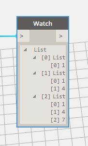

Hi Dimitar - no not quite. I wish for it to list the index number of every instance where it says true. In your example the end list I would expect to see is the one below.

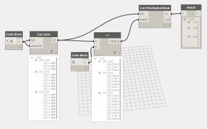

I’m not sure how this could be used exactly, but hopefully it solves your problem:

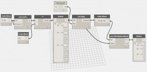

Dimitar you beauty! That’s exactly what I needed. Wonder if you could elaborate on the latter part and explain what is happening? Here is my example mixing it around to check it still functions…and it does! I will show you my end goal once I have reached it. This is a very useful tool though

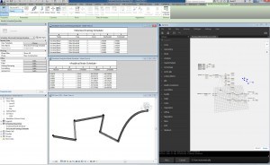

Below shows what I wanted to achieve. In a nutshell:
Extracting XYZ of analytical nodes
Extract Revit ID of analytical nodes
Push this information back into Revit for scheduling
Extract start and end points from the curve used to create structural framing
Compare this to the node points finding instances which match
Plug in the Revit ID for the nodes into a parameter in the framing family
Finished article: Have two schedules one for analytical nodes and one for structural framing members that can reference each other
With the help of the Map node, the Count node gets the total length of each sub list.
That number is reduced by one because lists in dynamo start from 0 and then it is fed into a number sequence (which again starts from 0) to match the list indices.
Finally because you’ve already defined a conditional statement, we can reuse that conditional statement to filter only the list indices that match your predetermined conditions.
