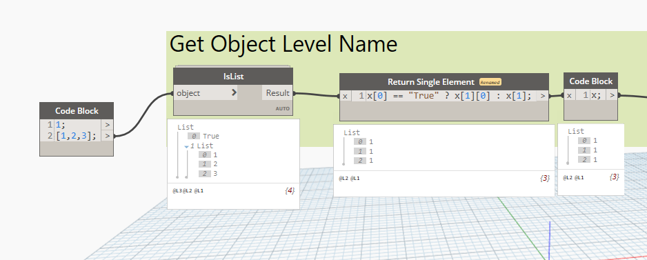

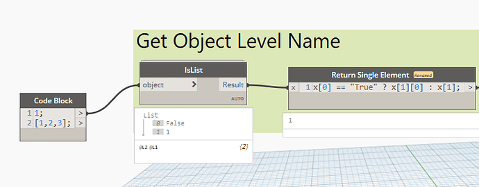

I wrote a code block which is supposed to receive an object X and if the X[0] == “True”, return the first object on the list X[1][0], else return the object itself X[1]. It works when feed it with a single object but when I feed it with a list it doesn’t work properly.
Is there something I’m doing wrong?
Feed of single object
Feed of list
This is how if statements work in a code block, as they don’t have any means of replication guides or lacing control. Therefore if you feed a mismatched list of booleans, true values, or false values you will always get shortest lacing applied.

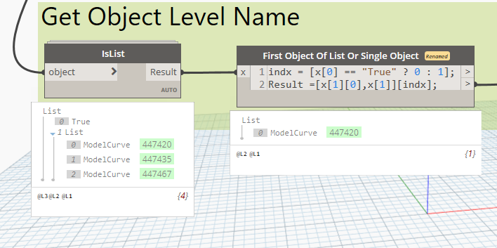

So when I change my code to the following it manages to return the single member (as supposed to the previous code) but it still gives me the whole list as supposed to the first member of the list. Any way to single that out?
Can you also expand on why the condition didn’t respond well to condition “X[0] == ‘True’ ? 1 : 0” but it does to “X[0]’ ? 1 : 0” ?

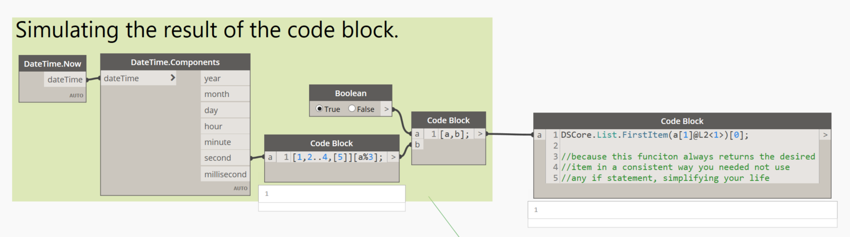

My thought on the list.first item was to just use that line of design script, or the List.FirsItem node. Not sure that an if statement is needed.
a workaround using Level (@L1)
listworkaroubd2
Another solution, by converting the elements to a list (get the first index)
listworkaroubd
My previously proposed method. Should be a bit quicker than flattening the list as it won’t need to pack the list into memory. My previously typed example used @L1 instead of @L2 though… sorry for the confusion.
