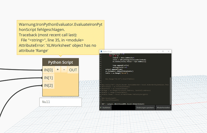

I am trying to export to excel via ClosedXML. It works but I can’t create a table because it does not find Cell or Range attributes. It can only find Cells and Ranges… Why is it like that? I can see that there is Cell and Range attribute under Worksheet class.

as Worksheet I have that:
but I need its subclass IXLWorksheet because I can add tables in its subclass (Range.CreateTable() or Cell().CreateTable()).
In C# you can specifiy return type of attributes.
For example: IXLCell c = ws.Cells(string "A1")
How can I return c as IXLCell and not XLCell in Python. I don’t know that…
I found something new:
The IXLWorksheet Class is an interface and XLWorksheet was implemented:
My question: how can I implement a class in IronPython?
