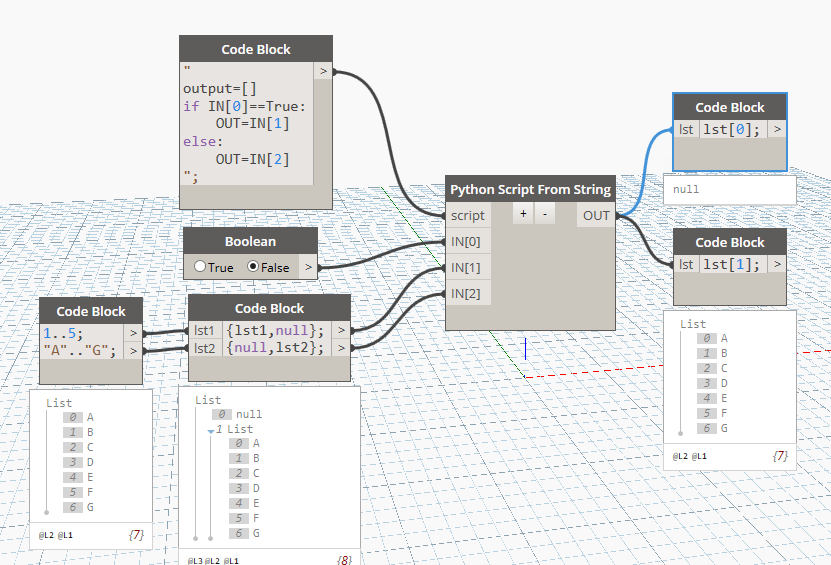

Hi @jacob.small
I’m not sure if this was changed in Dynamo 2.x but using designscript I do not quite get the expected result… (F and G are missing caused by the lacing i guess).
That isn’t been changed, though there are many alternatives which are equally efficient in design script (IE: indx = test? 0 : 1; lst = [lst1,lst2][indx];).
However in this case I read @Peter_Jenkins desire to pass two separate logic strings, one getting the list the other getting nulls and vice versa, not list A or list B (where the lists have differing lengths). ![]()
