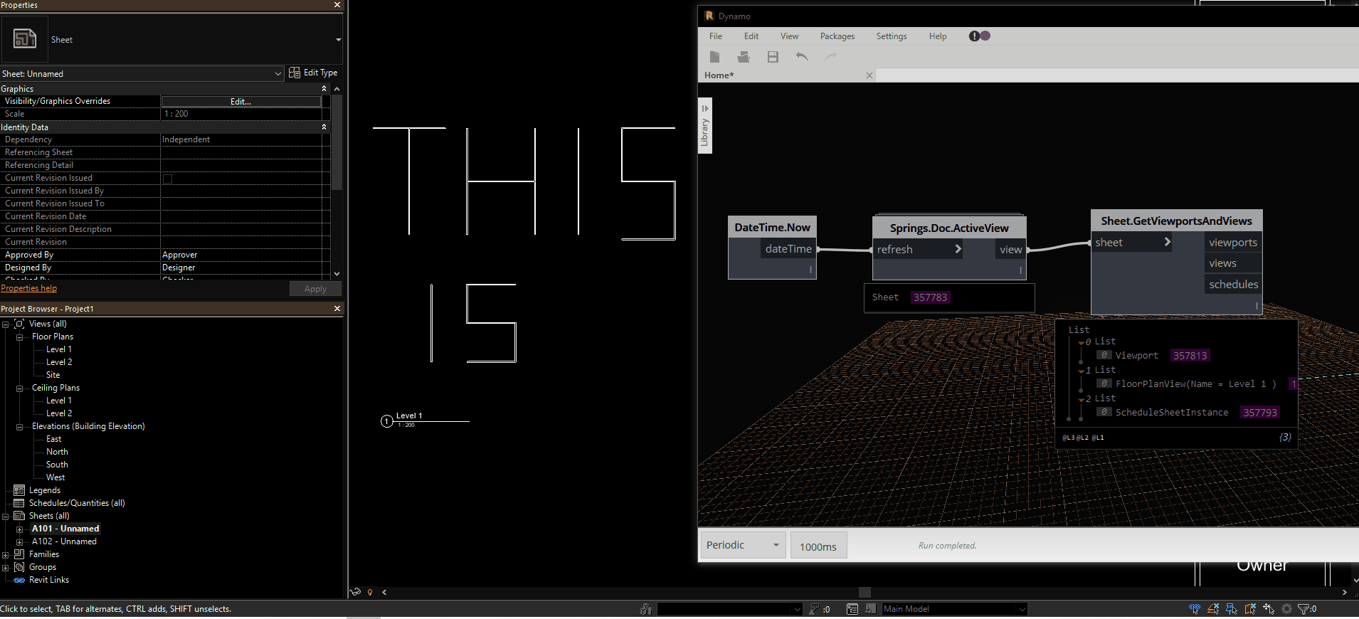

Try SpringsUI.Refresh thanks to @Dimitar_Venkov for his awesome package.

@jelloton How about Date.TimeNow running in Periodic mode. Be careful while running in periodic mode. Make sure you turn off when you’re done with your task.

I’m not sure how to run the DateTime node in periodic mode. It’s not working as I have it now.
Oh. That refreshes it, but I don’t want this running periodically. I need it to run manually only.
