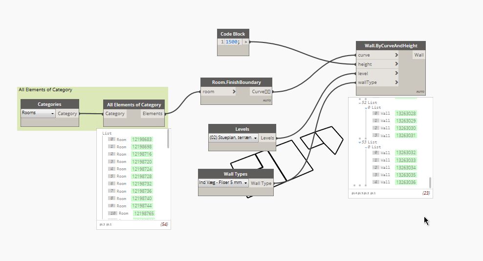

In this case i made automatic finish wall each room but my problem there is also a wall in door (see in revit Printscreen).the possible solution that i can see is to choose join command in revit but it’s take time. Can i know what is the additional node for this script to auto join the wall
thank you
