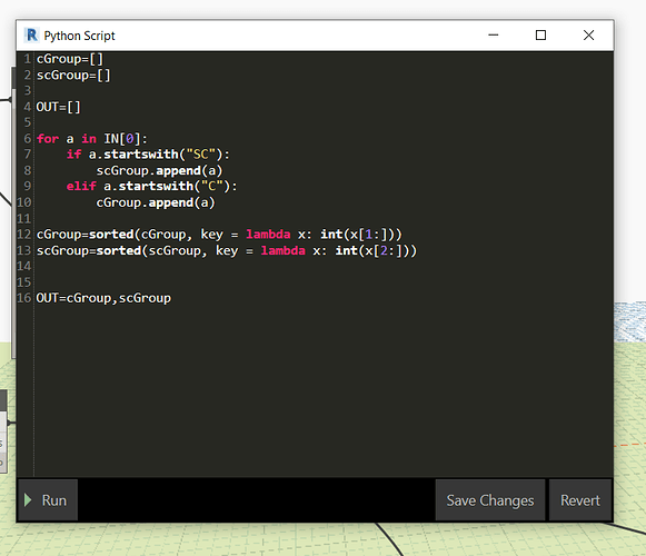

The following python code will help overcome issues with C2 being after C10 for example.
# Created By Brendan Cassidy
cGroup=[]
scGroup=[]
OUT=[]
for a in IN[0]:
	if a.startswith("SC"):
		scGroup.append(a)
	elif a.startswith("C"):
		cGroup.append(a)
cGroup=sorted(cGroup, key = lambda x: int(x[1:]))
scGroup=sorted(scGroup, key = lambda x: int(x[2:]))
OUT=cGroup,scGroup

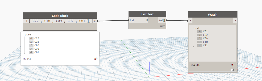

Good evening,
Here is a solution, necessarily improvable,
I begin
If you can’t find the String.GetNumber node, you have the one in the GeniusLoci package
(see picture 2)
Cordially
christian.stan

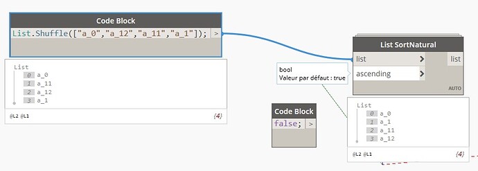

Good evening, you have the Swiss army knife node, List SortNatural from the GeniusLoci package
even faster :wink:
cordially
christian.stan
