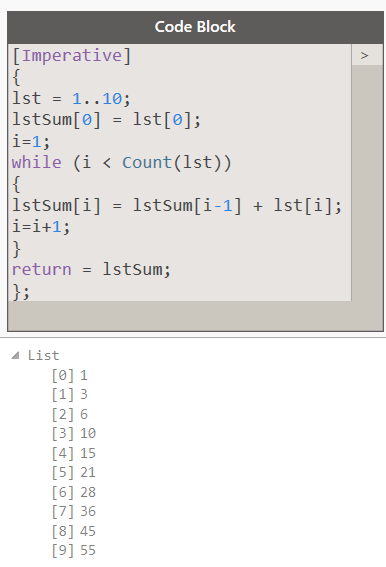

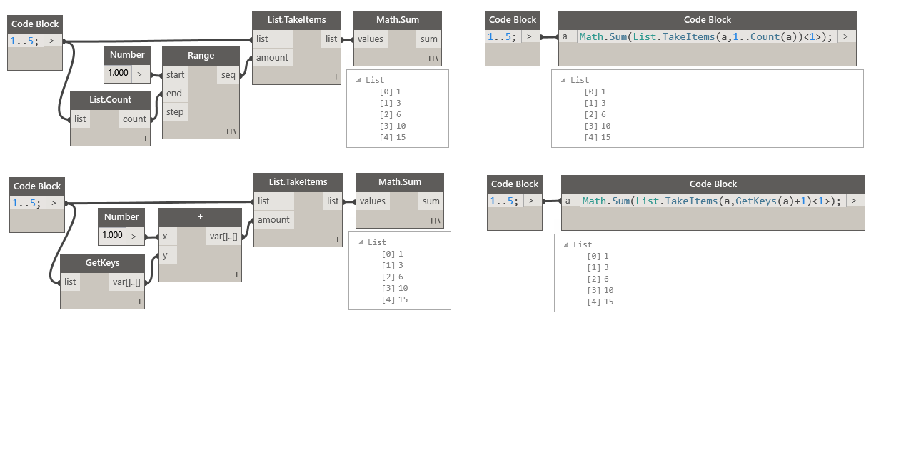

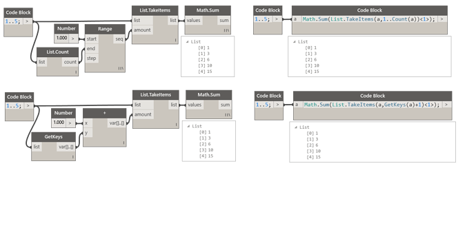

Matt,
Thank you very much. Both of your solutions work perfectly.

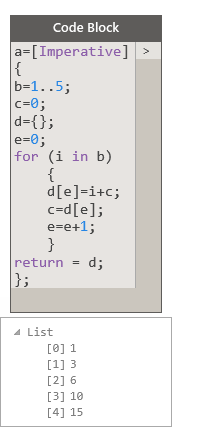

And a for loop?
a=[Imperative]
b=1..5;
c=0;
d={};
e=0;
for (i in b)
d[e]=i+c;
c=d[e];
e=e+1;
return = d;
