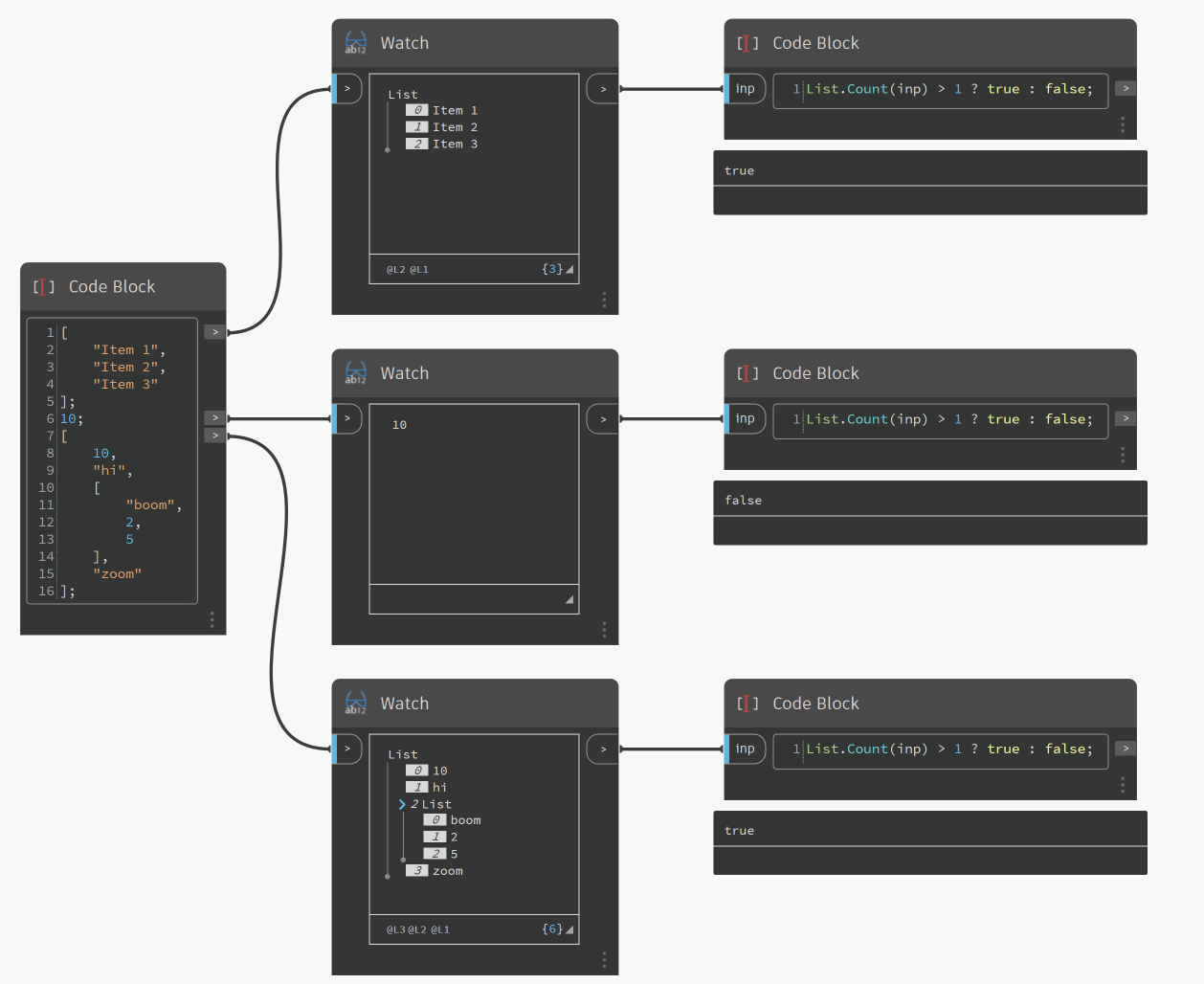

Hi, I just tried what you suggested but for some reason I’m not getting anything.
My original goal was to check if an element is a list, like the top nodes in attached pic. When that didn’t work I tried your code, like in the bottom nodes and that is also returning null.
Am I doing somethin wrong? Is there something I am missing?
Update: I tried writing your short code on a new file and it works - I guess when I got an error window with my first try it damages the file for further code.
So my question would be: how would to check in the imperative language if the input object is a list?
I have the same question also!
@zvith here is one option using DesignScript and an If Statement ![]()
List.Count(inp) > 1 ? true : false;
