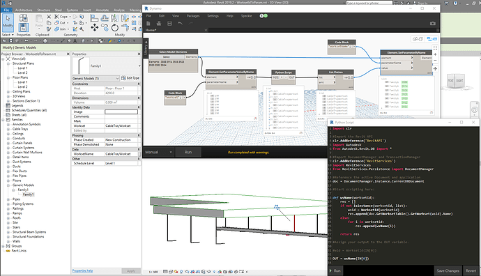

Hi @kameron1967,
You could do it like this:
Python script:
#Import the Revit API
clr.AddReference('RevitAPI')
import Autodesk
#Import DocumentManager and TransactionManager
import RevitServices
#Reference the active Document and application
#Start scripting here:
def wsName(worksetid):
res = []
if not isinstance(worksetid, list):
wsid = WorksetId(worksetid)
res.append(doc.GetWorksetTable().GetWorkset(wsid).Name)
else:
for i in worksetid:
res.append(wsName(i))
return res
#Assign your output to the OUT variable.
OUT = wsName(IN[0])
You could get the WorksetId aswell as the name, but I just think the name will be easier to understand if other people in your organisation where to use the data :-). The WorksetName parameter is just a project text parameter, and can be scheduled:
If you just want the ID, then just skip the python part and create an integer parameter instead of text parameter, or convert the output of the Element.GetParameterByName to a string.
Good luck
