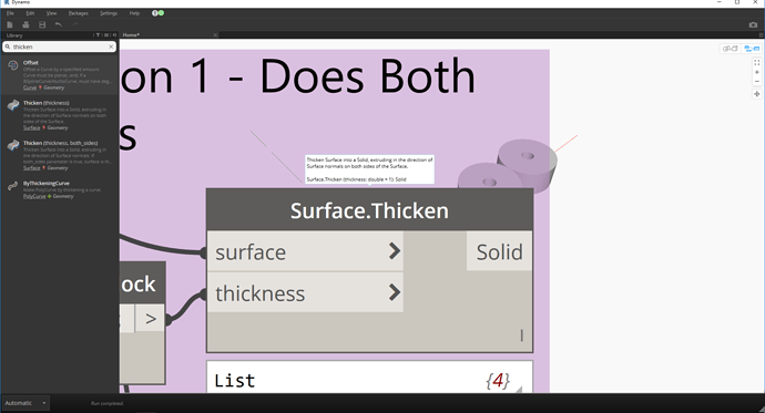

Good question! It is because the Surface.Thicken node thickens on both sides (this node may have been updated since the Primer example) therefore there will be a distance of 1 at their closest. If you hover over the node you will see in fine print what it is doing (get familiar with reading this as it is generally quite descriptive)…
In your case you will need to use the other Surface.Thicken node…
and it will look like this…
Therefore the complete graph (tidier than that of the Primer Version) will look like this…

You are right there, the node was fixed somewhere between 1.0 and 1.1.1:
