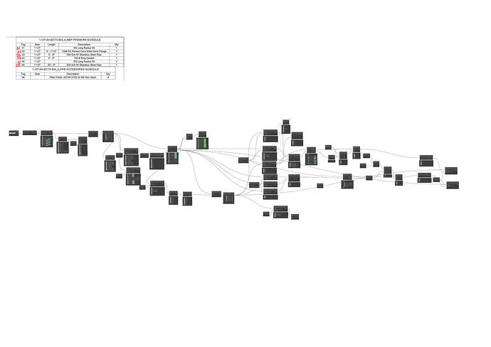

I’m trying to automate spool tag numbering in Revit using Dynamo. However, identical family instances (or elements with the same properties) are not being assigned the same tag number as expected. I’ve been troubleshooting the graph but haven’t been able to identify the issue.

maybe not sure, but if this should could happend you will at least zoom in your image, and all nodes expanded as we cant see whats goin on

I hope this image is clearly visible sir
@sovitek
almost there try do an image export as in the link i showed and do exackly that…then it really works cheers
Actually i did exactly as you mentioned, but node names are not shown in the image
no worries, zoom in a single node so you can see the node name and then export, and no worries dynamo export image tool do the rest so all is visible
Thank you sir, now its clearly visible

I find it a bit hard to tell which Element in your table (from the first screenshot)
is what Element in your List(s) in Dynamo (second screenshot).
If you can send a Project with at least the Elements in your screenshot i am
willing to make a cleaner (working) version of your .dyn.

The project file is too large to share, but I can share the Dynamo (.dyn) file here. I hope it helps identify the issue. If anyone can take a look and point out what I’m missing, I’d really appreciate your help. @bvs1982 @sovitek
Spool Num.dyn (99.7 KB)
Try keep it simple. Something like this?
thank you @Mike.Buttery Thanks for script i will try this & share the final solution here
Hi Mike,
It’s working for me now. Thank you for your help!
