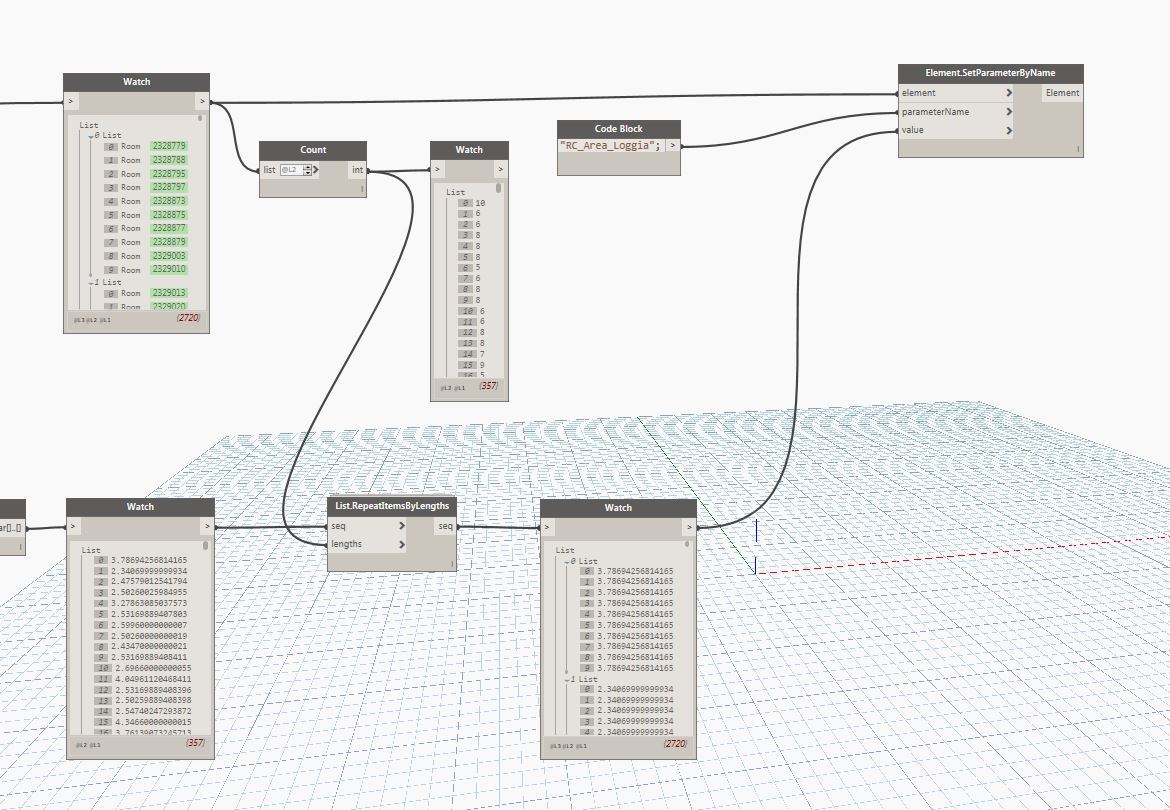

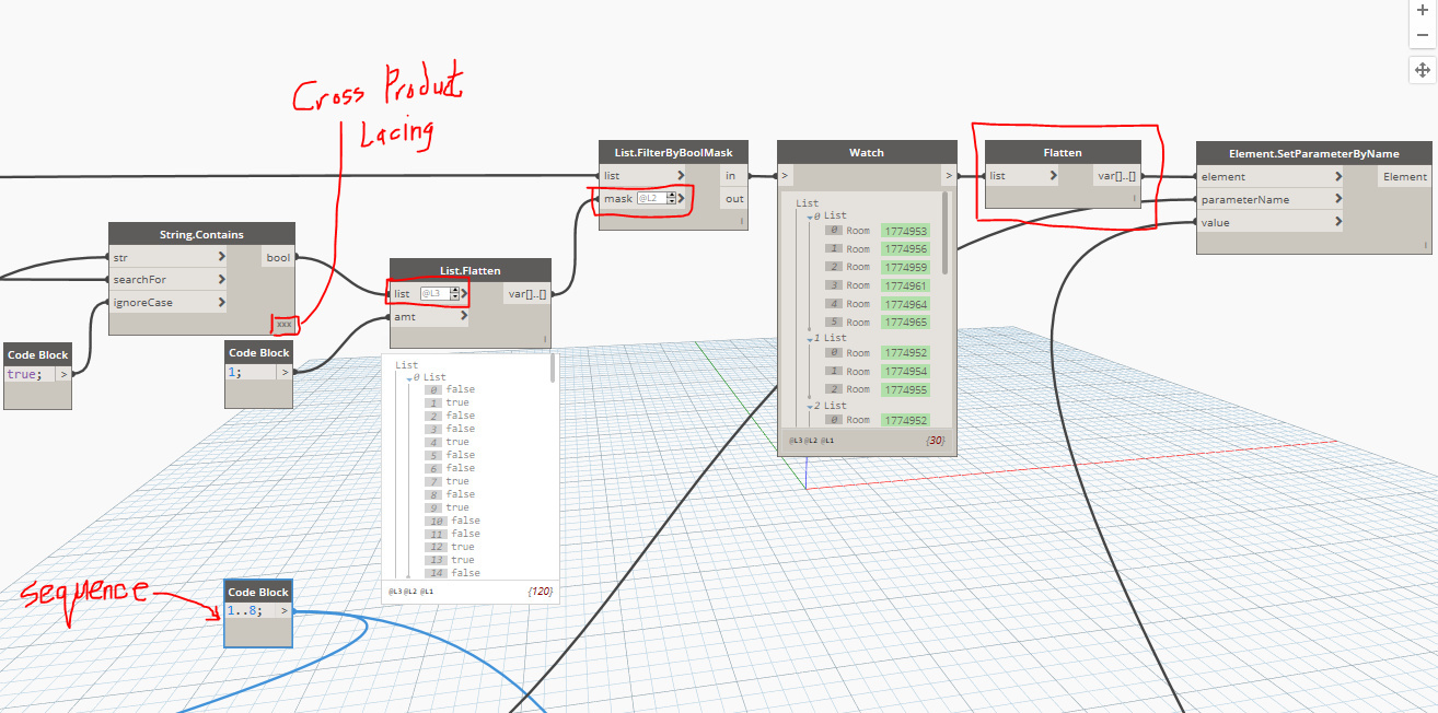

I’m trying to obtain parameters from one list, apply some logic and set some parameters to another list.
Goal: Pick a Room in set A, check if a certain parameter matches the parameters of all Rooms in Set B. if true assign another parameter from Room in Set A to Rooms with matching parameter in set B. Repeat until all Elements in Set A are checked.
So far i have managed to do it one by one but would like to automate so i give a sequence from 0 to 300 and corresponding rooms in Set A are checked against set B and so on.
What is not working is that when i assign a sequence it does not loop but it just checks all element in the given sequence against all elements in Set B.
