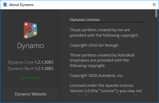

Are you using standalone dynamo ?

I use the one inside Revit on “Manage” tab.
