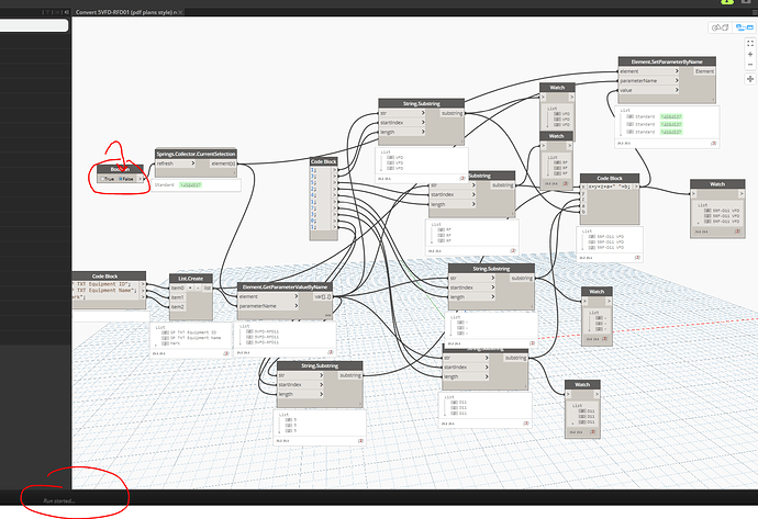

Here is what is looks like on an “endless script” which apparently today, isnt “endless” lol
You don’t have any elements selected.
I’m still guessing that your data inputs don’t line up. Try running your graph with multiple elements selected, but don’t connect to the SetParameter node. Instead, connect to watch nodes for each of the SetParameter inputs so we can see what’s going into that node that’s causing it to fail.
The last picture was taken when I had multiple elements selected. It looks funny because it didnt work. Thats the problem. I am trying to run it again adding the watch lists, and removing it from the set parameter node like you said right now, but it is taking forever. I might have to kill it.
If you look at your Collector.CurrentSelection it’s returning an empty list.
Oh well maybe that is why it ran that time then, I thought I had them selected. But I definately have them selected now, and it is in an endless loop again now…

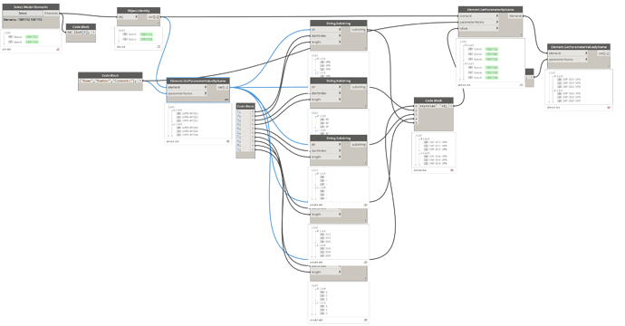

Single element:

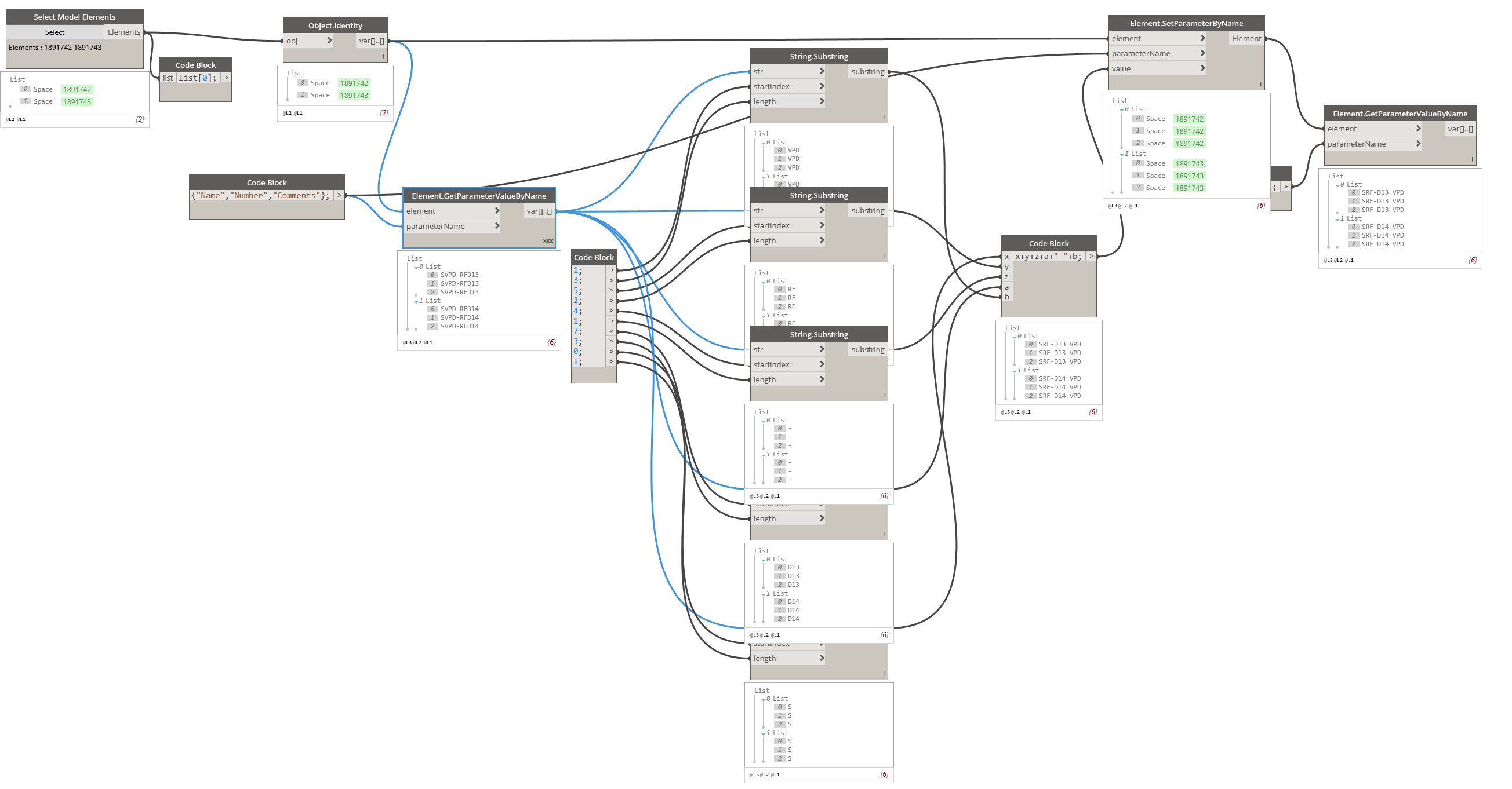

Two elements:

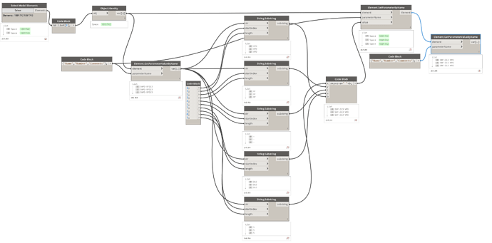

Well I changed my get parameters node to cross product and I got it to work on one selected item, the same as before. Then I toggled the boolean node and selected two elements and again, it is now running in another endless loop.
