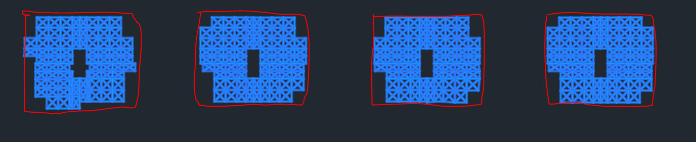

In the picture red outline is what i want

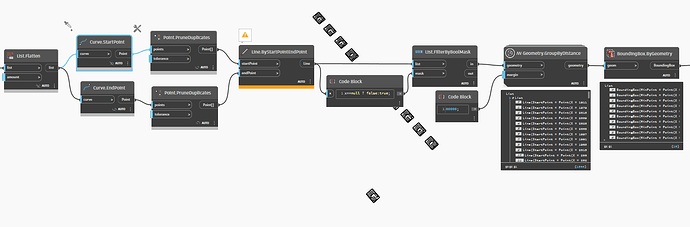

Hello and welcome, im not in dyn in the moment, try group these curves in 4 curve area, try group by distance from spring, and use a BoundingBox.ByGeometry…but you are welcome share that cad :wink:
something here maybe…

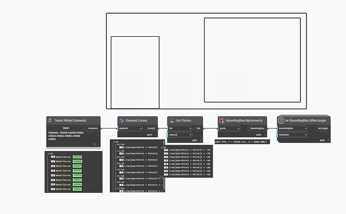

Hi try something here and see if it could work for you
@sovitek thanks its working, but if I have curve not mesh how would I get mesh

allright we can only help with that cad you shared and is has only one layer, if its another cad and another situation i cant help you , right now…for get the mesh on your shared cad just select as i try show in the image
thanks @sovitek, I think I got the workaround here
