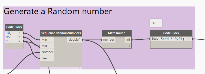

I remember seeing a piece of code to force a random list to regenerate new values. Can any one point me to it?
Basically i want to randomize a new list every time i hit run
Here’s what i’m try to re-randomize
 ![](https://us1.discourse-cdn.com/flex022/uploads/dynamobim/original/2X/f/f8b5f47b27226c82ce9d8e04af05e4e75771159b.png)

Are you referring to this post?
> [@How to generate an input to vary over time?](https://forum.dynamobim.com/t/how-to-generate-an-input-to-vary-over-time/3170/6):
> I have a little trick that can do that with the help of the “Web Request” node. It is the only node OOTB that enables periodic runs of a graph. You also need a simple web address that changes every time you refresh it, like for example this one: [https://www.random.org/integers/?num=1&min=0&max=100&col=1&base=10&format=plain&rnd=new](https://www.random.org/integers/?num=1&min=0&max=100&col=1&base=10&format=plain&rnd=new) Now you can refresh any custom node or function, as long as you have the result of the “Web Request” node as an arbitrary input. I use this workaround to generate …
