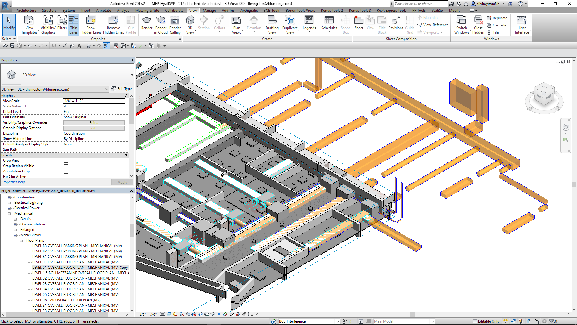

I am running a script that checks for interference and when its complete I am seeing my queried elements still highlighted.
Is there anyway to turn this off? The “orange” elements in image are what I’m talking about.
Thank you.
Thank you.
I think that’s just from the geometry preview. Try turning off background previews under your View settings.
That was it. Thank you very much.
