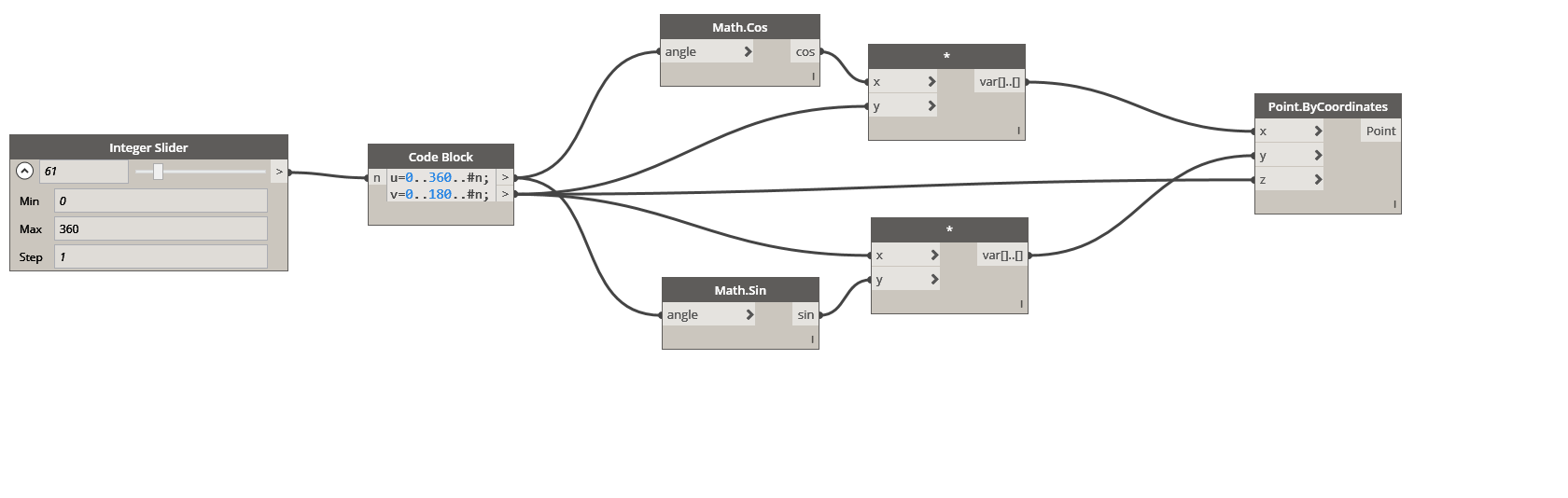

I am pretty stuck on this relatively simple matter. What I have is this path formed by these points but they are spaced equally. How do I do this but with each distance increasing slightly ( like a fibonacci sequence) following the same path ?

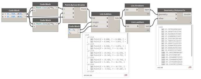

@h.hristov31 The points are in your graph not spaced equally, the distances are already increasing slightly
The graph below extends yours a bit to show the distance between successive points…
