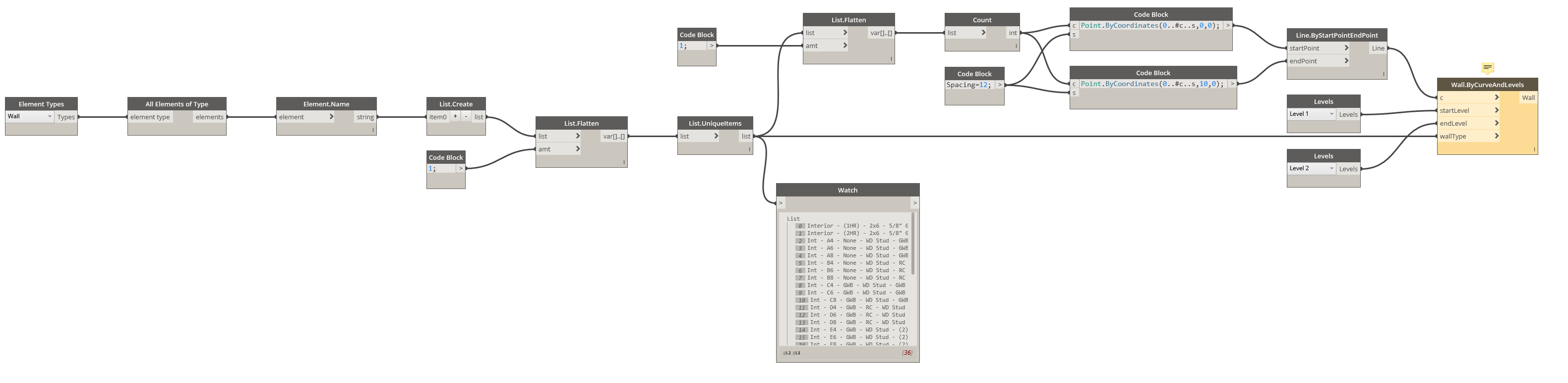

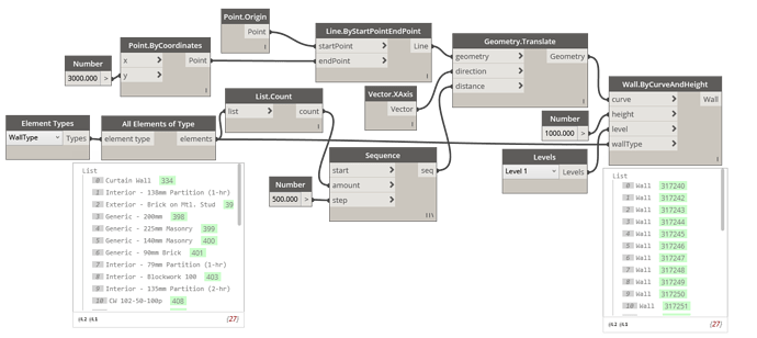

I’m attempting to put together a graph that can pull all wall types in the model, used or unused, and create a series of them for some QA through schedules. I’ve figured out how to place a single wall but it requires an input for each wall type, meaning I’d need dozens of nodes. I do have a graph that places unused types of families (GM, specialty, etc) in a nice line but it doesn’t seem to work with walls and none of the nodes I’ve found so far seem to pull the unused wall types.
Is it possible to pull all the wall types in a format that would eliminate the need for dozens of nodes? If so, how will the placement work? The place types graph uses a design script and I have no idea how to translate the wall by point into a design script.
The Place Types Graph
Can’t find unused wall types
I can place walls at least
About what I’d like to achieve
Thanks!
